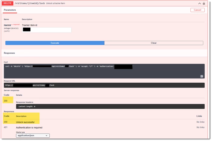

Hi @Ran , there could be other ways to handle this issue, I am sharing just an idea to remediate it once it happens: a user with permission to execute REST API calls could unlock the item with the DELETE /v3/items/{itemId}/lock endpoint:
  • <yourserver>/api/v3/swagger/editor.spr#/Tracker item/unlockTrackerItem

alfonso_c14-AlexandriteAnswer
Aug 1, 2024 6:48 AM UTC

Hi @Ran , according to https://www.ptc.com/en/support/article/CS427862, it seems there are currently no other ways to prevent this behavior.
As my suggestion to use the DELETE /v3/items/{itemId}/lock endpoint is the only potential workaround so far, I am marking my preceding answer as "Accepted Solution".  If you have more to share on your issue, please let the Community know so other community members can continue to help you.
