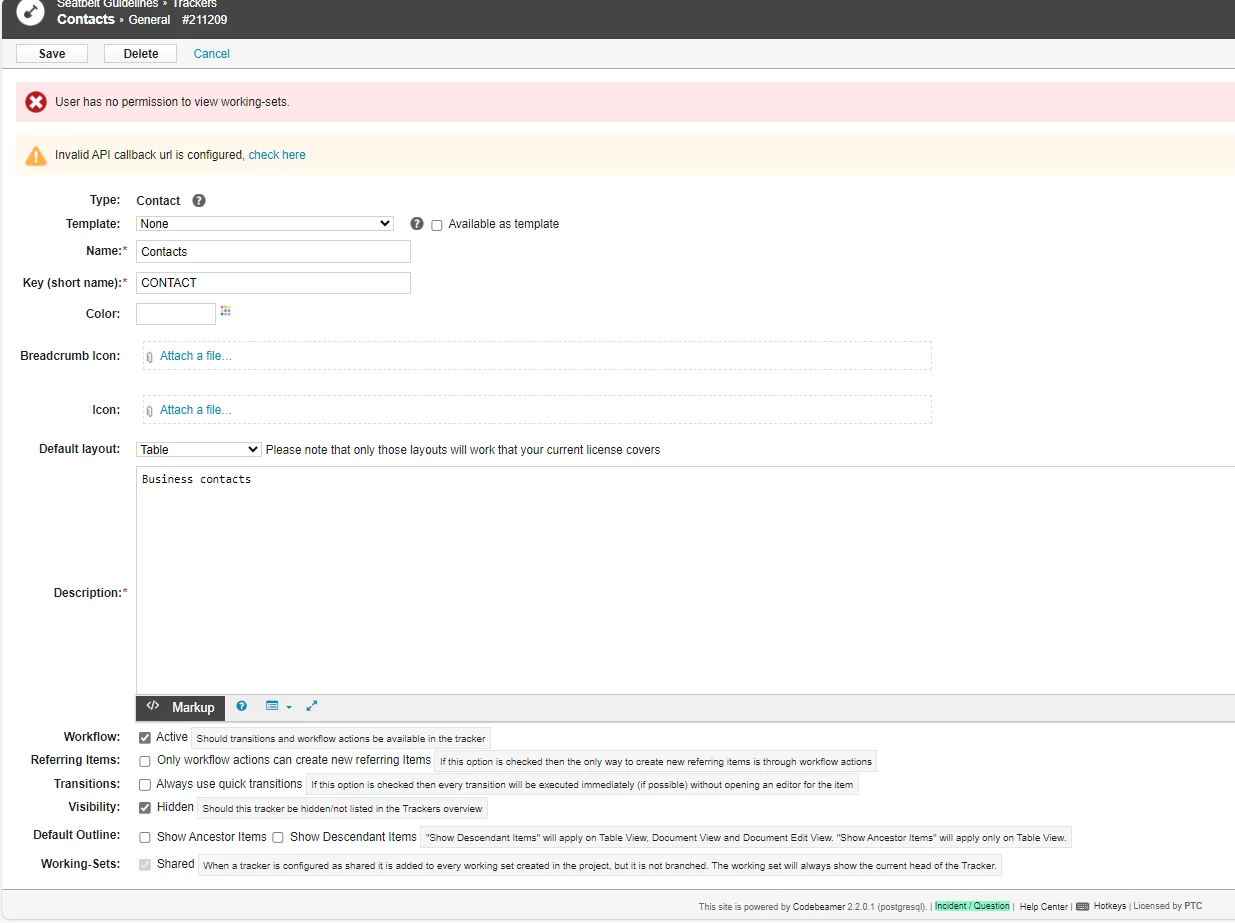

"User has no permission to view working-sets" when deleting tracker.
I made a new CB project which generated several default trackers that I didn't need. When attempting to configure and delete the trackers, I receive a message that states, as attached, 'User has no permission to view working-sets", and the tracker cannot be deleted. For now, I have just hidden trackers that are not relevant.

you can read about Working Set (the needed license and permissions) here: https://support.ptc.com/help/codebeamer/r2.2/en/index.html#page/codebeamer/user_guide/14296583.html
Nov 18, 2024 10:46 AM UTC
It's because that tracker is included inside Working set. and you don't have enough permission to view the WS.
if u want to remove the Tracker, then u need to ask someone to delete the tracker who has modify access of that WS.
