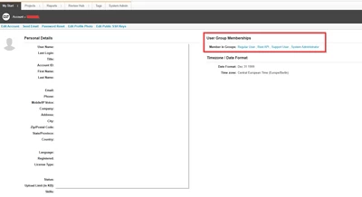

Hello Community,
I am trying to figure out where in database (MySql) is stored User Group Memberships for particular user account.
I found table "acl_role" but this seems to be related to project only.
Goal is to create a query which link user_id with it's roles/memberships in Codebeamer.
thank you

Notes:
  • Replace 'your_user_login' With the actual login name.
  • This will give all global user group memberships, as seen in the User Group Memberships section of the UI you shared.
  • These roles determine what the user can access across the entire Codebeamer system, not specific projects.

Jul 31, 2025 6:53 AM UTC
Hello pshashipreetham,
unfortunately following tables does not exist in our MySQL database:
cb_user_group
cb_user_user_group
