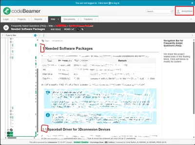

Hello team,
we have strange behavior of wiki page appearance for logged in and anonymous user.
If wiki is opened by anonymous user then formatting and text block denote is correct and page shows :
1 Needed Software Packages
1.1 Spaceball Driver for...
etc.
Example below:

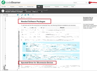

But after user log in then denote disappear.
Is it a bug or wrong page setting?
Codebeamer  version 22.10-SP7
thank you

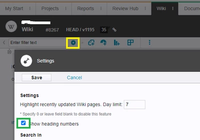

Dear @MM_10991077 ,
thank you for your question.
Try the following steps:
1.) Login with your user in Codebeamer.
2.) Open the affected wiki pages.
3.) Click on the yellow marked "settings" icon and be sure that you activate the green marked checkbox
4.) Did the above change solved the problem? Let us know please.
Thank you.
Jul 11, 2024 9:37 AM UTC
Hello gkosa,
thank you for hint.
It works but seems that it must be set for each wiki and anonymous/logged view separatelly.
Is it possible to set it as default?
thank you
