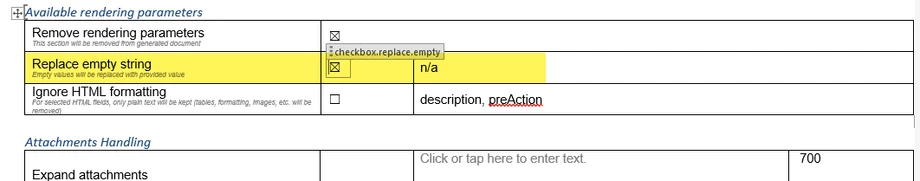

We are facing some issue in the exports of trackers in word format and i.e. where ever a field do not have any value, it is displaying it as '--' and we don't want this.
Is there any way we can resolve this by making change in the template itself?
Best answer by EvaBertalan
You can create a definition for empty values in a custom template: https://codebeamer.com/cb/wiki/5371368#section-Replace+empty+strings
In the "Rendering parameters" table check the box with parameter "checkbox.replace.empty" in, and add a string to text with parameter "string.replace.empty".
With this setting the empty values will be replaced with the provided string.
