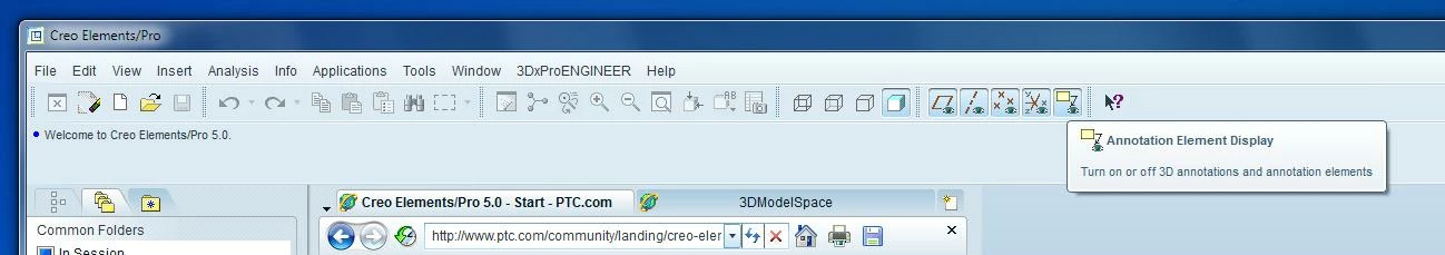

    For Creo Elements/Pro 5.0 M140 the Annotation Display is now a toolbar icon button on far right with all the display option buttons (see attached).
