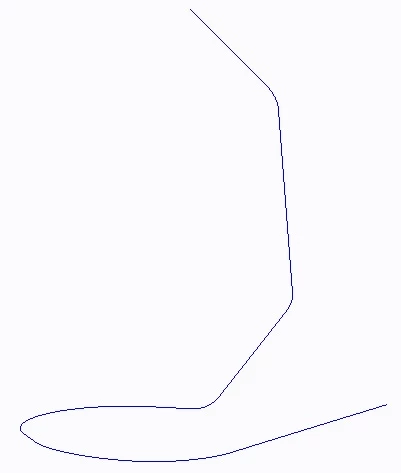

I am looking for a solution to create a 3D loop similar to one shown in the attached picture out of 2D arc segments.The 2D arc can have straight portion in the ends. Idea is to fabricate a 3D pipe using 2D bent pipes. Any suggestions to address this?

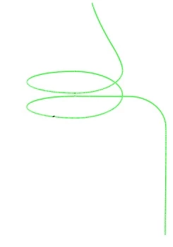

    Sorry if I am not very clear with my requirement. I donot want to copy the cuver form proe. I want to create a new 3D loop in proe which will be the centre line of the a pipe weldment. During this I will have only 2D bent pipe sections (similar to arc in 2d) which need to be assembled at the end of each section and orient in right direction to form the 3D curve. I will be having top end and bottom end of the 3D curve given as fixed one. Now in need to find out how to arrive on the individual pipe segments to form a circular loop and reach the top point from bottom point. Hope I am bit more clear now, please refer another loop attached which will give more clarity.

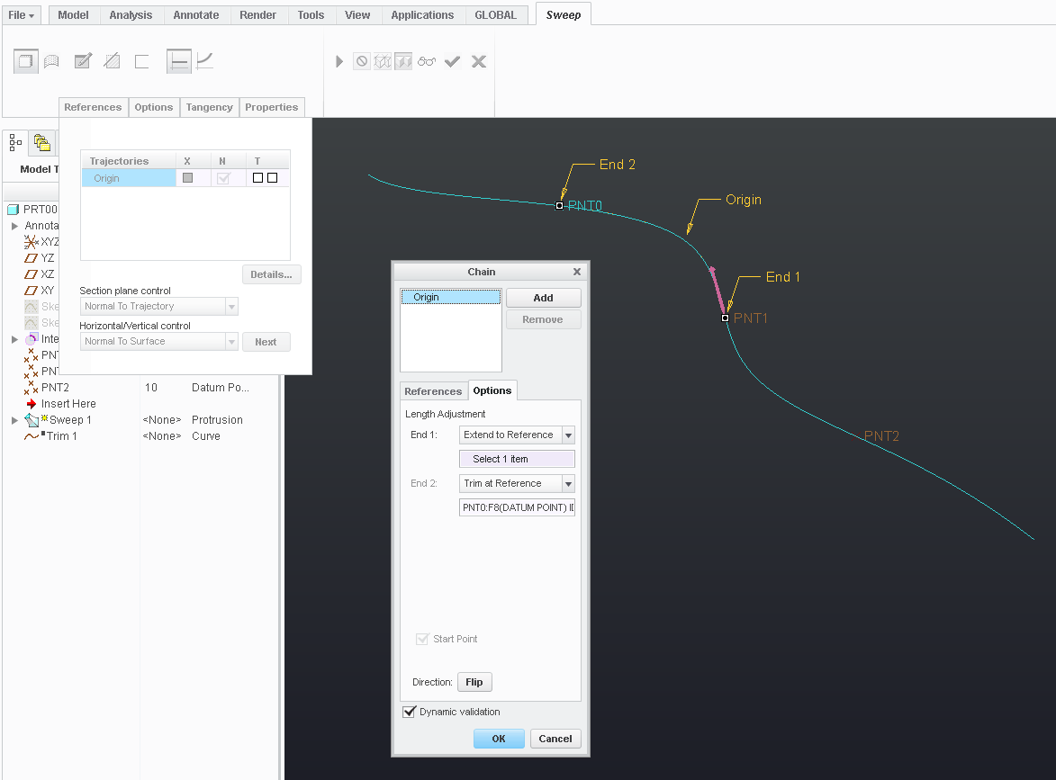

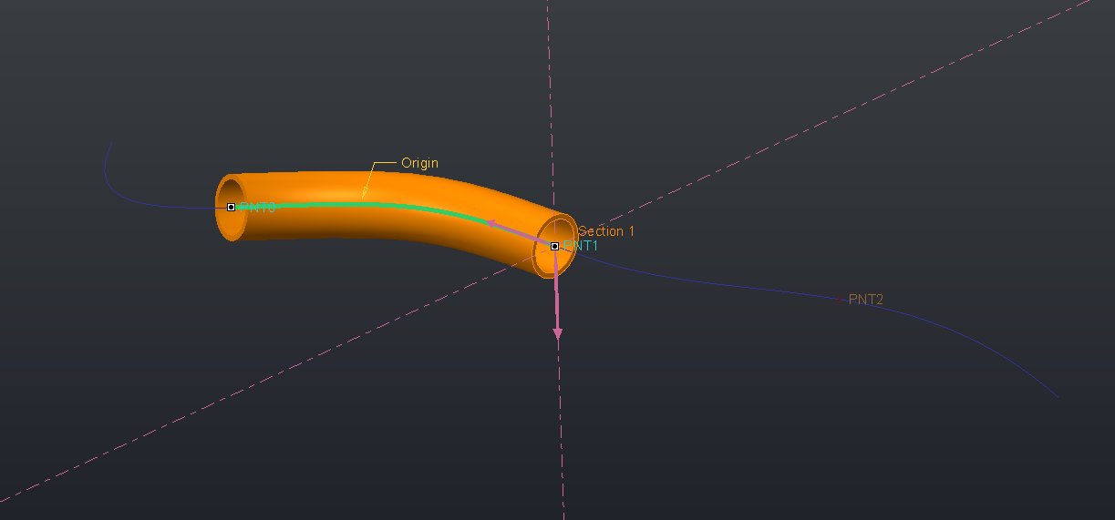

    Another method is to trim the curve "on-the-fly".  Let's say you're going to use the pipe segments in a sweep command.  Start by placing the datum points on the curve as before.  In the sweep command, select the 3D trajectory and open the trajectory detail window.  In the "Options" tab change the end length adjustments from "Value" to " Trim at Reference" and select two of the datum points.  Then create the sweep section as usual and repeat for any other segments.  I think this method is preferable.
