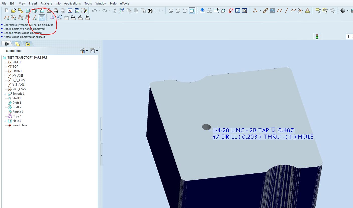

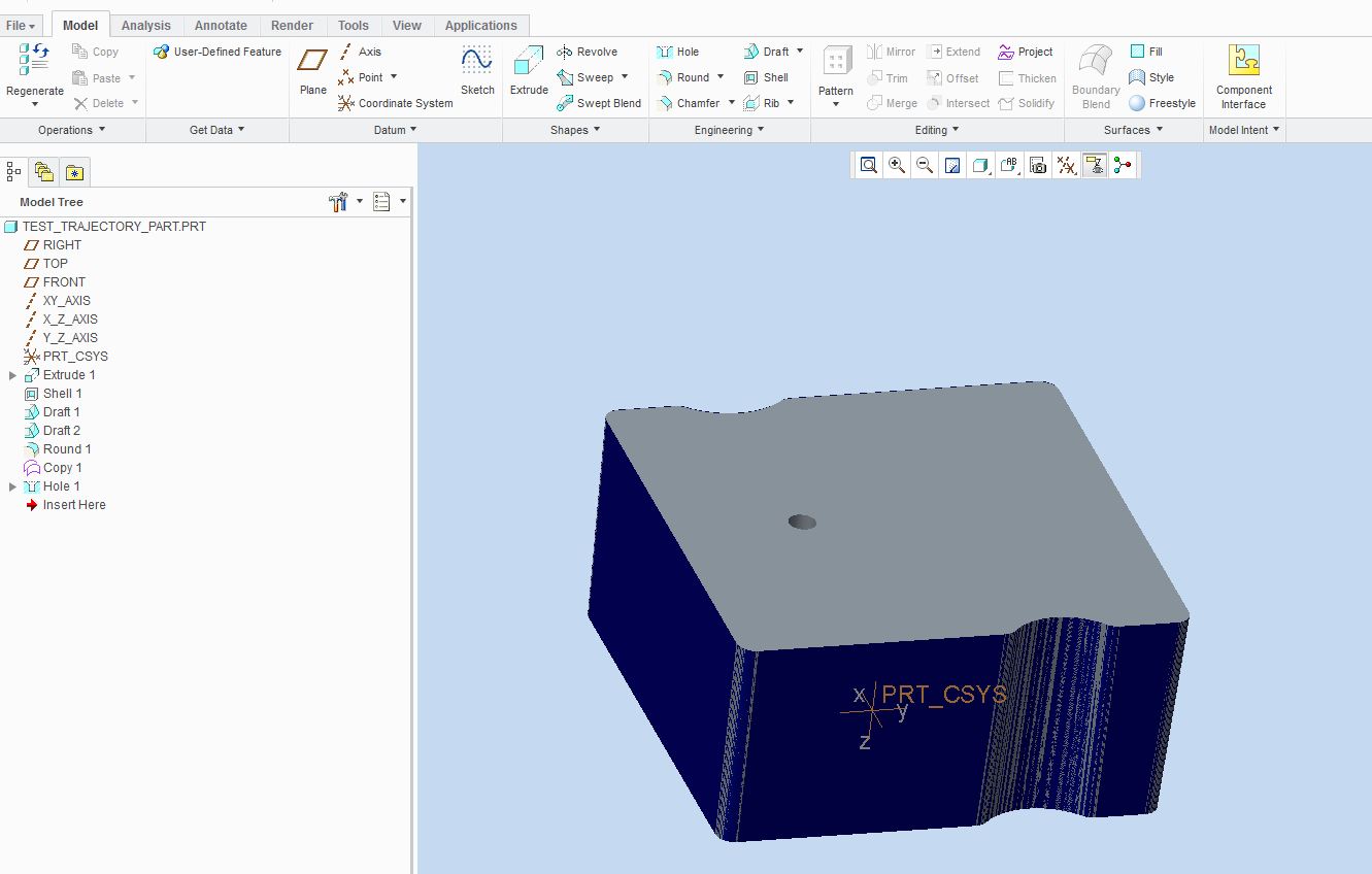

In wf5 I had an Icon that would turn on and off the display of hole notes. Now with Creo2.0 the icon appears to be gone along with the display of my hole notes?
how do I get them back? Creo2.0 windows7 64 bitPro

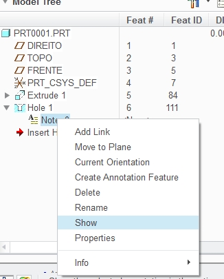

    Change to ANNOTATE tab and then Right Mouse Button on Hole's note and SHOW option.

    Aug 20, 2012 4:57 PM UTC
