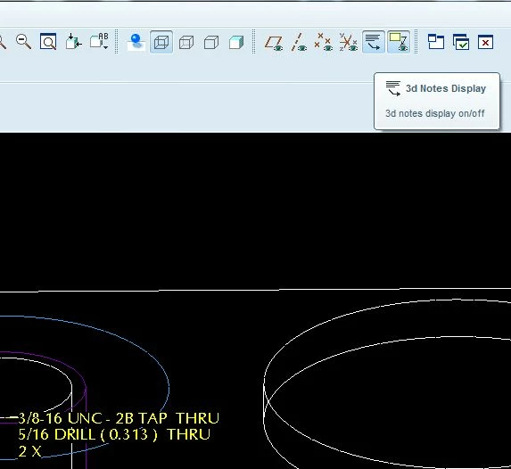

We used to use 3d notes display to toggle on the hole notes when convenient. This option seems to have disappeared in Creo parametric 1.0. How do you turn on/off the hole notes?

    The 3D notes icon is not in Wildfire as OOTB. Your company must have added it in a config.win file.
    You may have to rebuild your config.win files for Creo, since the menus and icons have all changed.

    Your correct that I added this to the config.win. However, it is not an option to add this to the menus in Creo 1.0. The icon no longer exists . I was hoping that it was replaced with some equivalent functionality as we often have plates with lots of holes, and this was an easy way to determine hole sets for manufacturing.
    I have received several other comments from others in similar situations. No one has found a way to do this, it appears this functionality has been removed.

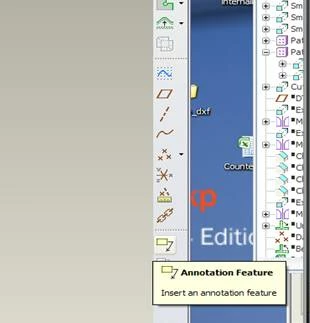

    August 30, 2011
