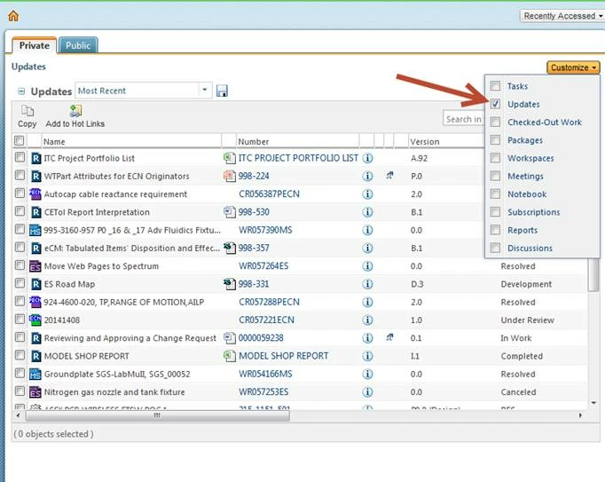

    Not elegant, but we instruct our 10.1 M040 users to use the "Customize" button on the right side of their home page and only check the table they are interested in viewing.
    When only one table is displayed, the scroll bars act much more predictably. I'm guessing it is the same in 10.2.

    You can also grab and drag the bottom of the Checked-Out Work table to make it larger than 3 items. (At least in 10.1.)
