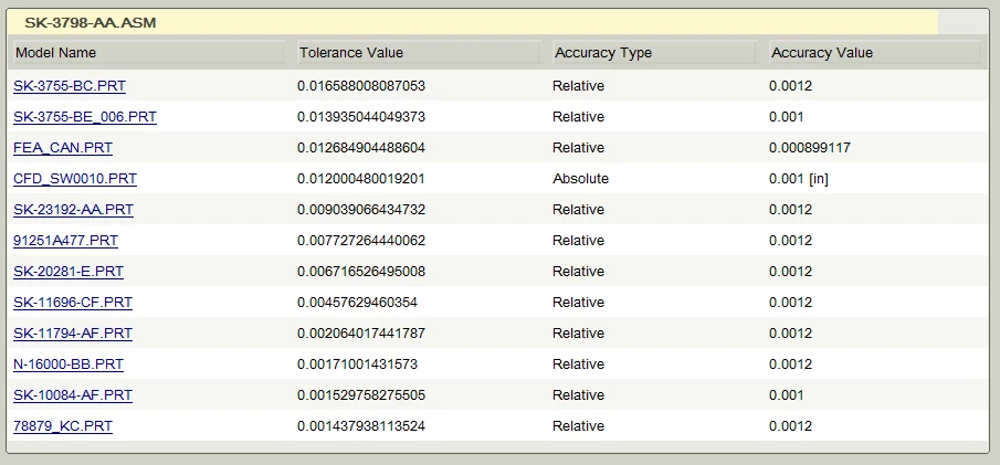

    This post solved what I wanted to get in an alternate method:
    If you are using mechanica you can get a list in the info window for all components in an assembly using
    Info > Tolerance Report
