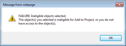

Add to project, ineligible object selected
One of our Product is giving this error when you try to add objects to a project.
[cid:image001.png@01D067C7.DE2E3F30]
I can add objects from a different Product to the project. So it's nothing to do with the project.
What permissions would cause this? Every user we have tried is getting the same error, even admin's.

    I guess I should update this. Found the problem.
    CS32686 says:
    that in order to add objects to a Project, the Product has to grant Change Permissions and Read permissions on objects in Product/Libraries.
    I had to add change permission to the product folder context where the files reside.
    [cid:image002.png@01D0687F.E7E00D20]
    After that everything works as expected.
    We are likely going to have to go thru a bunch of products and libraries and add this permission.
