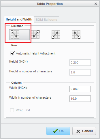

    For example, if the table is set to grow down and right, like this:

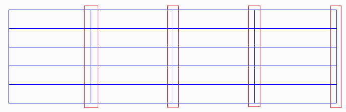

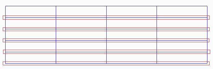

    To add rows you can pick on any of these lines:
    And to add columns you can pick on any of these lines:

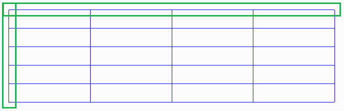

    Again, since these two lines define the corner (based on the selected growth direction), they can't be used for the add row or add column commands.
