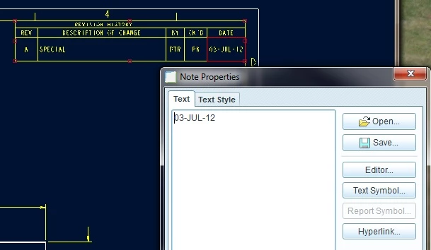

Adding today's date to a table
Hopefully this is a simple one just before a holiday.
I have a table that I update everyday to correct the date for the current (today's) date.
I use is up to 30X per day, so I save it to reduce the re-entering of the date.
Is there a way to save the table with a field or parameter so that when I bring it back in, it will automatically put in today's date?
I have done this before with sheet set ups, but not with a specific table.
Dale

    Just got the results from what I tried and it worked. If you want to insert a table from a file that inserts the date when you put it on a drawing you need to create and save the table from within the FORMAT environement.
    The second thing I tried was in response to people wanting a date that updated each day for keeping track of drawing changes. Although this doesn't update automatically with a refresh of the drawing sheet but it does work for updating the date each day. I created a variable text note symbol for the date. The variable text variable uses the &todays_date parameter as a predefined value. You can place this on a drawing although it can't be directly inserted into a table. To update the date select the symbol text and double click on it and a parameter value dialog will open with the current days date. You can also just double click on the text symbol or use the right mouse menu to open the symbol properties dialog box. Selecting okay will cause the date to update. If you type in a value it causes the value to no longer update with &todays_date but keeps the last value entered. You can open the symbol properties dialog and change it use &todays_date again. I tired this in WF5 and Creo 1.

    Hello Dale, you can create a parameter named "&todays_date" in the table .

    Dale_Rosema
    Jul 3, 2012 1:07 PM UTC
    Hugo,
    When I add the parameter to the properties, it places the date in the table. Then when I open the properties of cell of the table, it already has the date, and not the parameter. Is there a way to edit the table outside of a drawing? Typically I modify the table and then resave.
    Or is there something else that I am missing?
    Dale

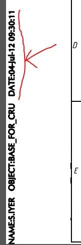

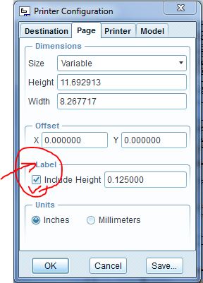

    Jul 4, 2012 4:01 AM UTC
    The parameter "&todays_date" takes in the system date, converts it into a text. Hence, it does not update. Another alternative is to remove the date from the table and instead print the drawing to PDF with Label ON. This would generate a PDF file with the current date.
