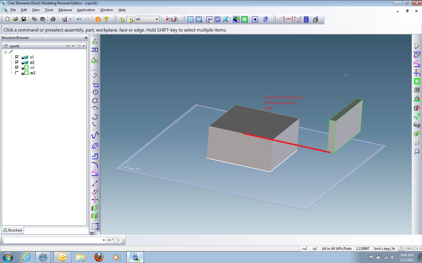

So I just downloaded creo direct and was playing around with it. This is a super simple question but can't figure out how to do it. Want I have is two parts, each a cube and I want to align the midpoints like this
So I tried using the position by two points tool, but the cursor doesn't seem to recognize the mid points of either edge. Any thoughts Thanks
Dennis
    Jun 2, 2011 5:52 PM UTC
    Hi Dennis !
    For catching the middle points of a line or a circle you must press CTRL + SHIFT together.
    Best wishes !
    Matthias
