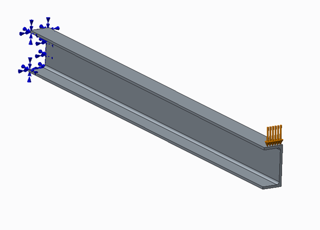

The problem to be solved is about as simple as it gets: a cantilever beam with a load on the end.
Figure 1
Unlike this beam from Galileo's Discorsi e dimostrazioni matematiche, intorno à due nuoue scienze, the customer's beam has a channel section and is made of aluminum.
Figure 2
The user provided three different, but equivalent models to represent the situation:
  • A beam model with a standard channel section,
  • A beam model with a solid sketched section
  • A 3D solid model (shown above in figure 2)

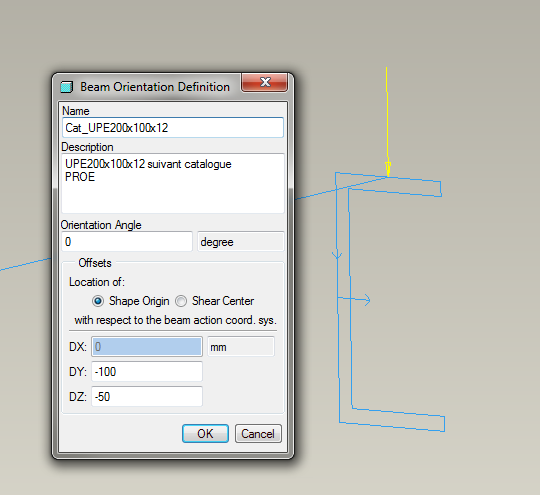

In the customer's model with the channel section, the user defined the beam orientation so that the loads are applied to the center of the top flange.
Figure 10
Note that the beam's reference curve and the applied force vector intersect.

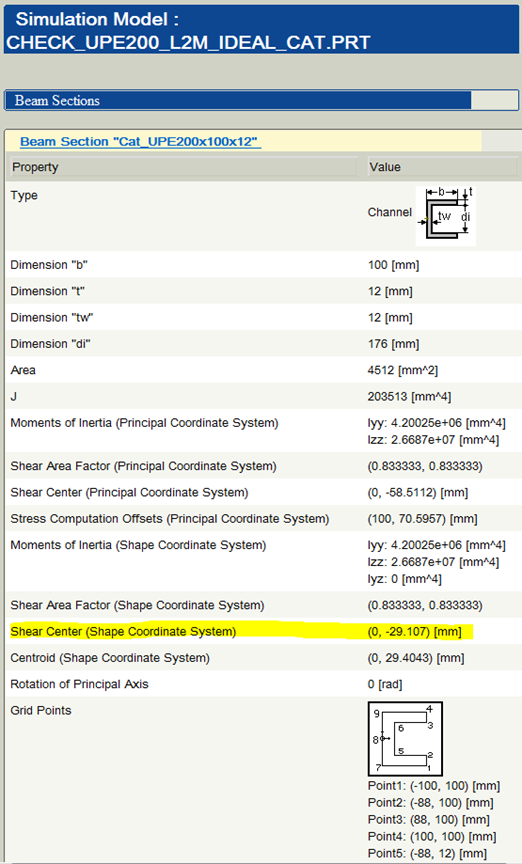

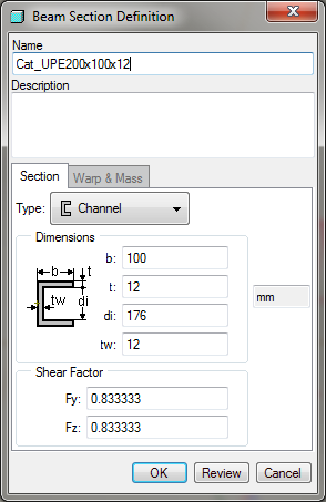

The beam section definition dialog for the standard channel section is shown in below…
Figure 11
… and its properties are shown when you press the Review button.
Figure 12
Note that the shear center is located at (0, -29.107) mm, measured in the shape coordinate system, as shown below.
Because the user did not align the beam's shear center with the action origin (compare figures 9 & 10), the applied load does not pass through the shear center and therefore when the beam is loaded, it both deflects and twists about the shear center. As described above, Simulate reports displacement and rotation results at the action origin. The action origin is moving due to both the downward deflection of the beam and the twisting of the beam about the shear center.

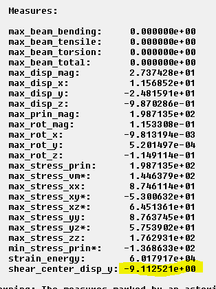

For comparison, we need to compute the deflection of the shear center from the Simulate results, as follows. The shear center is located -29 mm relative to the shape origin (see figure 12), which is -50 mm relative to the action origin (see figure 10). So the shear center is located -79 mm relative to the action origin. Simulate computes that the action origin at the end of the beam rotates -0.188 radians about the z axis and deflects -24.1 mm in the y direction.
Figure 13
Therefore the shear center deflects
-24.1 mm + (-79 mm * -0.188) = -9.2 mm
[The small discrepancy between the Simulate results (-9.2 mm) and the standard hand calculation (-9.0 mm) is due to the difference in the theories used. The customer's hand calculations used the standard strength of materials theory while Simulate uses the Timoshenko beam theory, which accounts for shear deformation.]

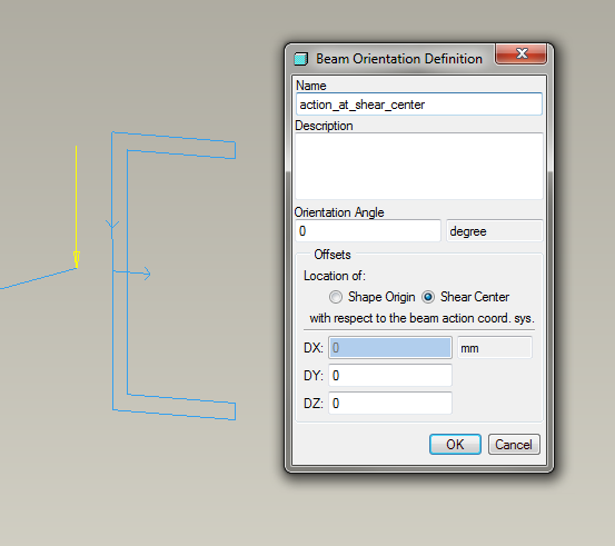

Another way to obtain the customer's expected theoretical result is to load the beam at the shear center, by defining the beam orientation to locate the shear center at the action origin, as shown below.
Figure 14
Notice how the reference curve and the applied load pass through the shear center. Running Simulate gives the same result as before, max_disp_y = -9.2 mm

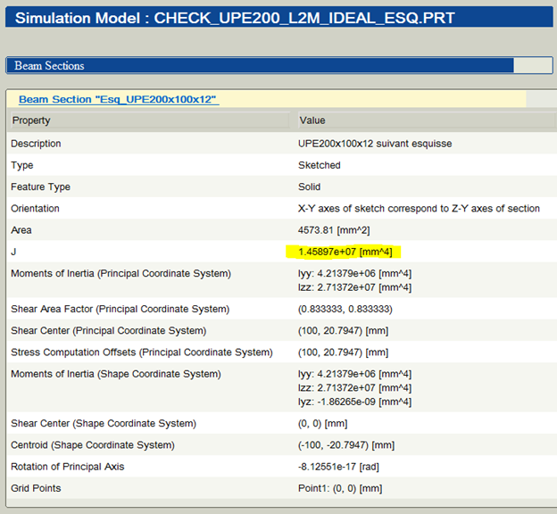

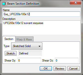

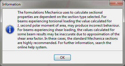

When editing the sketched section, this dialog appears:
Figure 18
As we know from the previous results, the beam we are modeling is in fact "experiencing torsional loading", because the applied load does not pass through the shear center, so this dialog is warning us that the results may not be accurate. Reviewing the section properties…
Figure 19
…we see that the second polar moment of inertia (J = 1.4e7), is much greater than that of the standard channel section (J = 2.0e6, from figure 12). So the warning message was correct and important. Also, notice that there is no entry for the location of the shear center. Simulate cannot calculate the shear center for solid sketched sections. (It can for thin sketched sections.) It is up to the user to enter that value on the Beam Section Definition dialog. In the customer's model, the shear center was set equal to zero:
Figure 20
Therefore, now we know why the model with the sketched section gives results that appear to agree with simple beam theory. Simulate thinks that the shear center of the beam is the same as the action origin (even though in reality it isn't.) Hence, Simulate ignores the moment induced by the applied force because it thinks the force goes through the shear center. As a result, the beam does not twist (max_rot_z = 0, in figure 17) and the computed displacement of the action origin is not affected by any rotation. So the displacement computed at the action origin (and supposed shear center) matches the hand calculation for the shear center.
Suppose we try to correct this error by entering the correct values for shear center on the Beam Section Definition dialog in order to reproduce the results obtained by the first model. Unfortunately, Simulate will not compute the correct results because the value for J is much too high.
The main take-away from this example is: it's best to not use solid sketched sections for asymmetric beams.
(Note: It is OK to use thin sketched sections for asymmetric beams because in this case, Simulate can compute the shear center.)

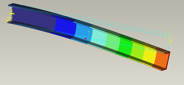

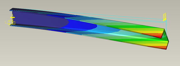

3D model
The 3D model captures all effects and this (magnified) deformed view of the displacement magnitude clearly shows that the beam is both deflecting and twisting.
Figure 21

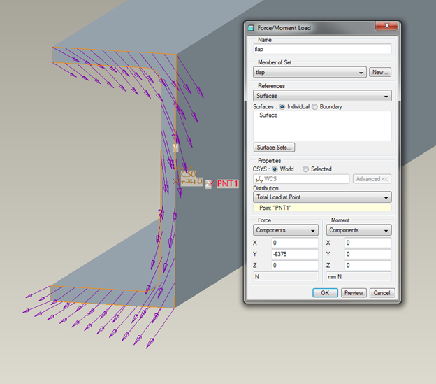

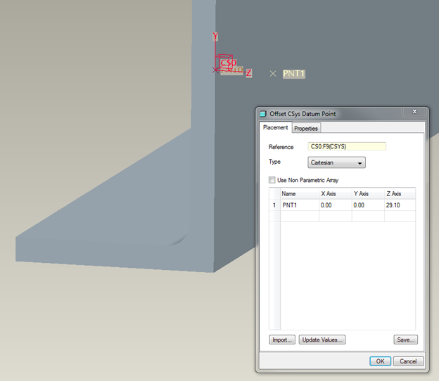

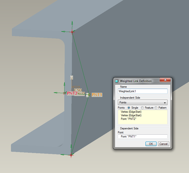

In order compare the results for the solid model with the results for the two previous beam models, we must compute the deflection of the shear center. But how do we do that if the shear center is a point floating in space, not connected to the model? Here's one way.
  • Create a datum point at the location of the shear center. (Here we are using the shear center computed for the standard section from figure 12. The standard section is nearly identical to the section of the solid model, but not exactly.)
Figure 23
  • Tie the movement of this datum point to the movement of the beam's web with a weighted link.
Figure 24

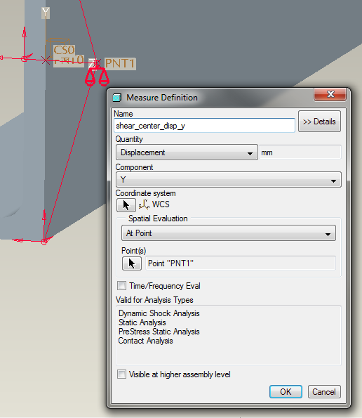

  • Create a displacement measure on the datum point.
Figure 25
Running the analysis gives the expected result:
Figure 26
As a final example, let's see what happens when you load the solid beam at the shear center. To do so, we could either create a weighted link, say between the shear center and the end of the beam, or we could create a total load at point. We'll choose the later, just for variety's sake.
Figure 27
Notice that a force applied to the shear center is equivalent to a force and moment applied over the end surface of the beam.
