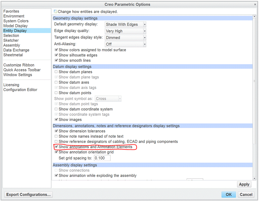

hi,how could i close annotation element display when i start pro-e?

    Harrison,
    you can set config.pro option model_note_display to yes or no. Or you can switch the setting using UI.

    Mar 26, 2015 12:22 PM UTC
    thank you very much.
