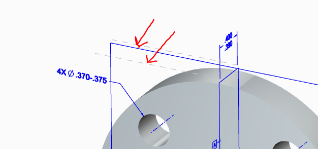

I asked support as well but I suspect you guys know... and if not, I will post it here.
I could not find the option, or even where the option is hidden for these projection lines from 3D annotations like dimensions.
Anyone here know or remember?
Best answer by TomD.inPDX
display_z_extension_line in config.pro
Only took 3 calls to convince the service rep that there really was such an option.
Now we know.
TomD.inPDX17-PeridotAuthorAnswer
July 9, 2014
Now we know.
