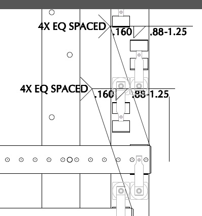

Annotation showing up when printing a model
I am printing out a model (parts on a fixture) and I have annoations that show up.
This only happens on a few prints. Any thoughts on what may be causing this and what I need to change to prevent it.
See below:
Thanks, Dale
    Dale_Rosema
    Mar 14, 2014 12:03 PM UTC
    I went into the generic part and used the selector to choose Annotation. Then chose and hid the annotations and saved the part. Now the annotation no longer print out on the assembly.

    They are look like DDAE in model. I guess someone converted into DDAE as I did a few days ago! go to Annotation > detail, they maybe show there, to delete them, they will not be DDAE and will not show in printed model.

    Are you talking the annotation tab in the drawing? I am only in the model and not in the drawing at all. I do not see an annotation tab in the model.
    Thanks, Dale
    Mar 13, 2014 5:47 PM UTC
    No, I talk Annotate in model.
