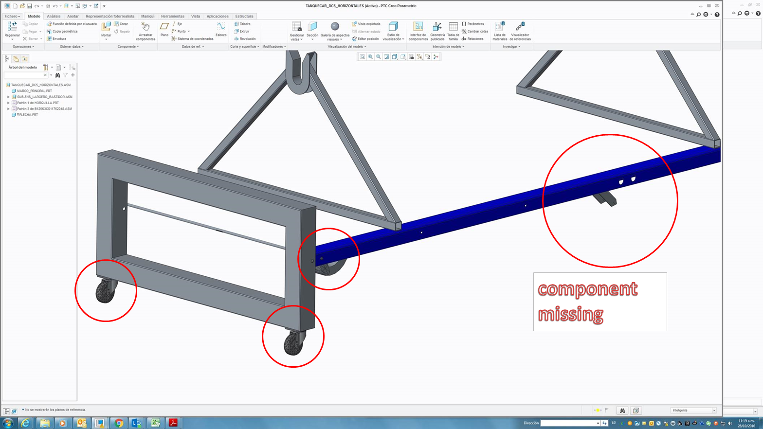

Anyone could tell me if is possible to avoid a distortion image after to use "drag component". I have added a picture

    I can't see from your image what the problem is
    melias1-VisitorAuthor
    Oct 28, 2016 4:49 PM UTC

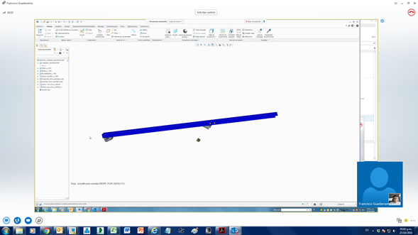

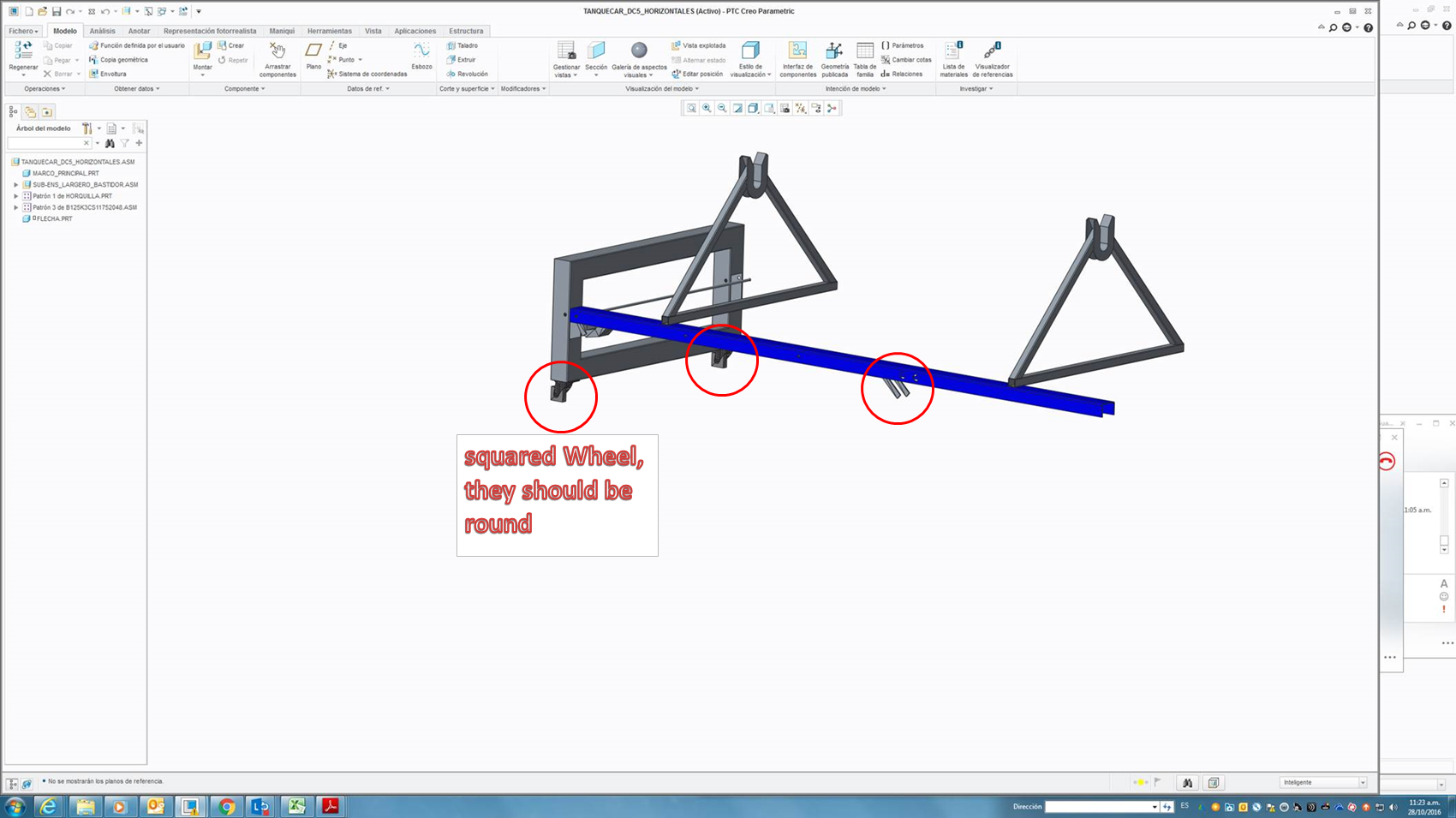

    Hello, I have added you  some pictuctures about the issue, these troubles uccur after to use "Drag Components", Do you  Know How to avoid it??

    StephenW23-Emerald IIIAnswer
    Oct 28, 2016 5:55 PM UTC
    That looks like a level of detail problem.
    Go to FILE - OPTIONS - MODEL DISPLAY tab, then turn off the "use level of detail for the shaded model when manipulating the view"
    Try it after that and see if you still have the problem.
