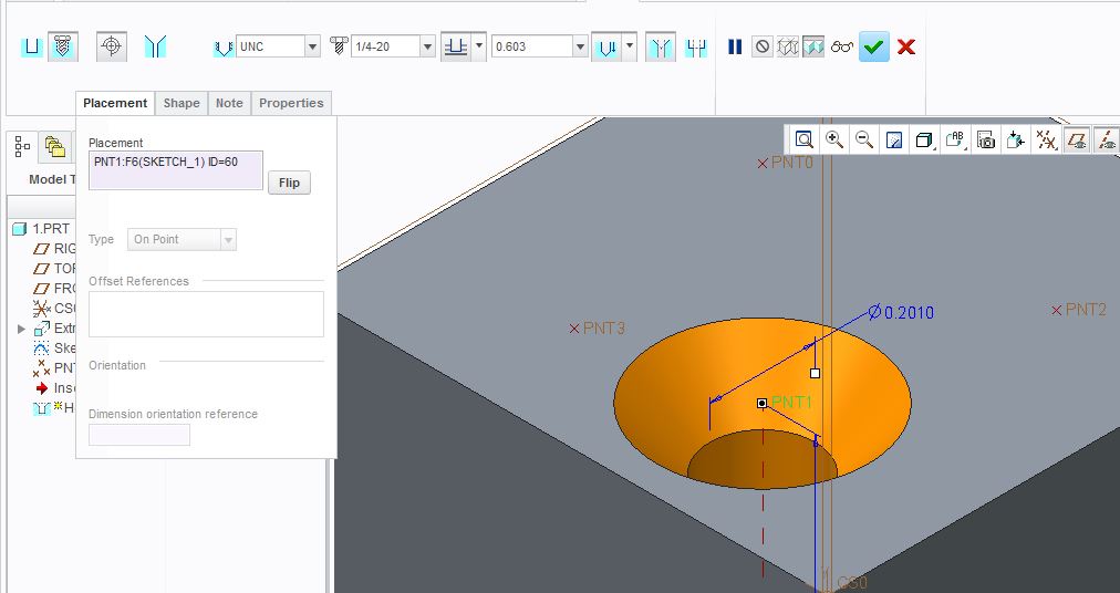

    One notable exception would be CP3 adds point sketches to define hole placement - waited ~10 years for that.
    Feb 3, 2016 9:20 PM UTC
    You can use a datum point or a sketch point to define hole placement in CP2 as well, or are you referring to intelligent fastener?
