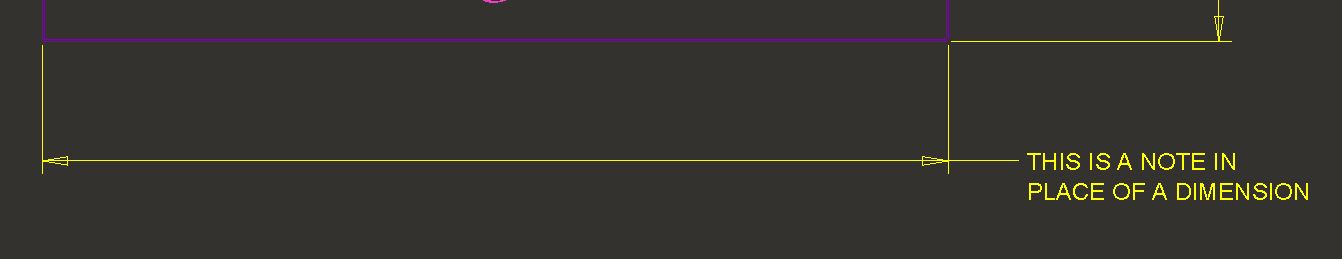

hi,
I am new user of creo software. I wanted to know how to draw  a double sided arrow without dimensions. I need it to add a note.it would be very much helpful if reply soon to my problem.
regards
sharath
    Aug 3, 2016 2:54 PM UTC

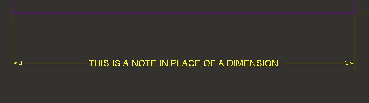

    If this is what you are talking about, all you have to do is create a dimension and then go into the dimension properties and go to the "Display" tab and change the @D to @O (Capital O and not zero) and then type the note you want to display. Then you can change how it looks an appears on the drawing in this dialog box as well. Then once out of the dialog, you can drag the note where you would like it to be. Hope this is what you are after.

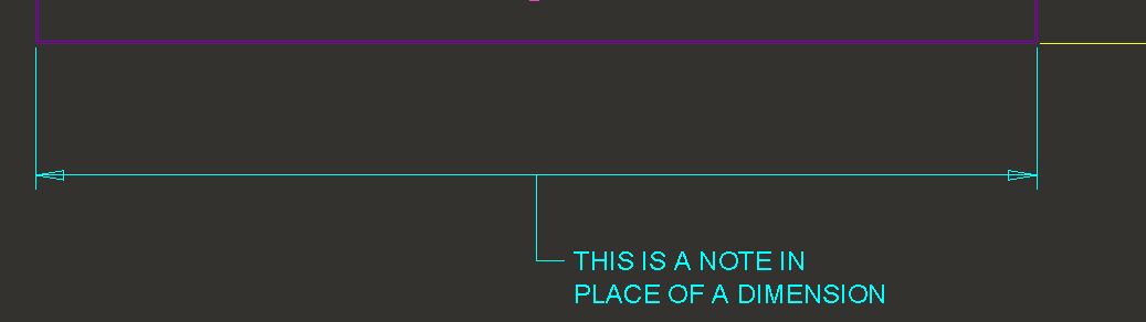

    Hi Martin,
    Thanks for the reply, but its not working .when I select the arrow I am not getting the arrow style option.
    In the arrow style I don't have the 2 sided arrow head option. Kindly let me know how to represent the note in this manner in creo drawing.

    It working.. thanks a lot shane.
