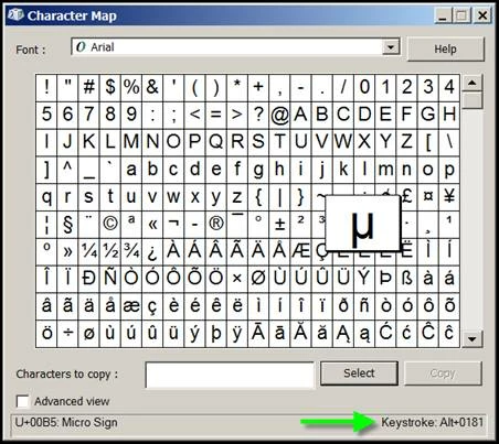

how do you get ASCII text into a note in WF3 I need a µ. in a note.
I have been on Olaf's website but I can't get his way to work??
Any ideas?

    Press Num Lock key. Hold down ALT and type 0181 in the number keypad.

    An alternative to this (if you never chance the size of your note font) would be to create a µ symbol and just insert the symbol in your note.
    An even better alternative is to switch away from the PTC "FONT" since it is not a real font file (thus the problems) and move to a monospaced font. There are several out there (off the top of my head, there is one in the Lucidia family provided with Windows and one in the Liberation family that was developed for Red Hat and is a free font family).
    Apr 28, 2011 12:35 PM UTC
    To get list of the ASCII codes you can run charmap from Start > Run
