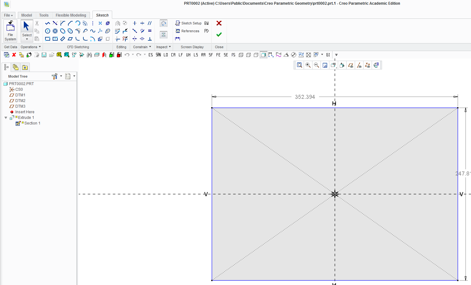

I am at home and only have Creo Parametric 2.0 and 3.0 Acedemic versions available to me. I can change from my usual "gradient" as shown below in screen shot 1 to black on white by selecting:

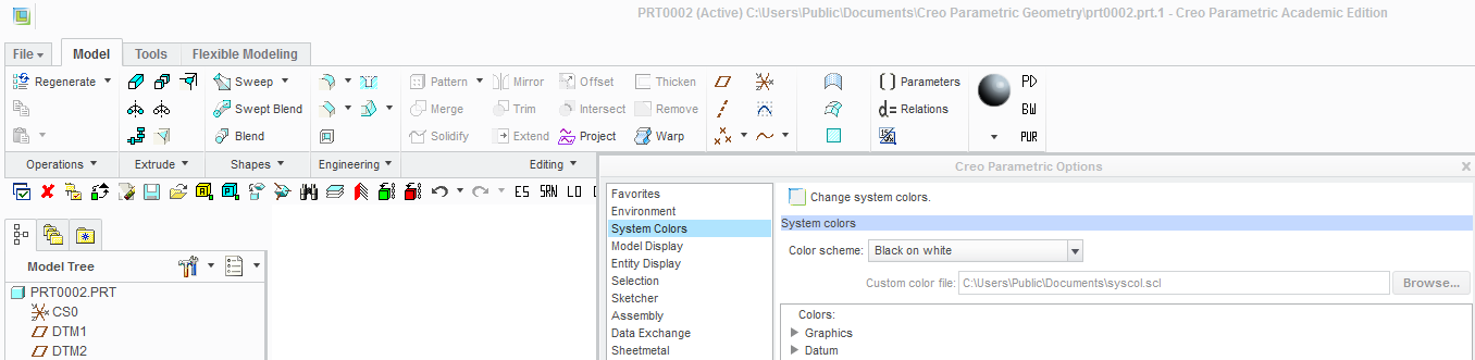

File \ options \ system colors \ Color scheme
Then pick (my choice):
Default
Dark background
Black on white
Custom

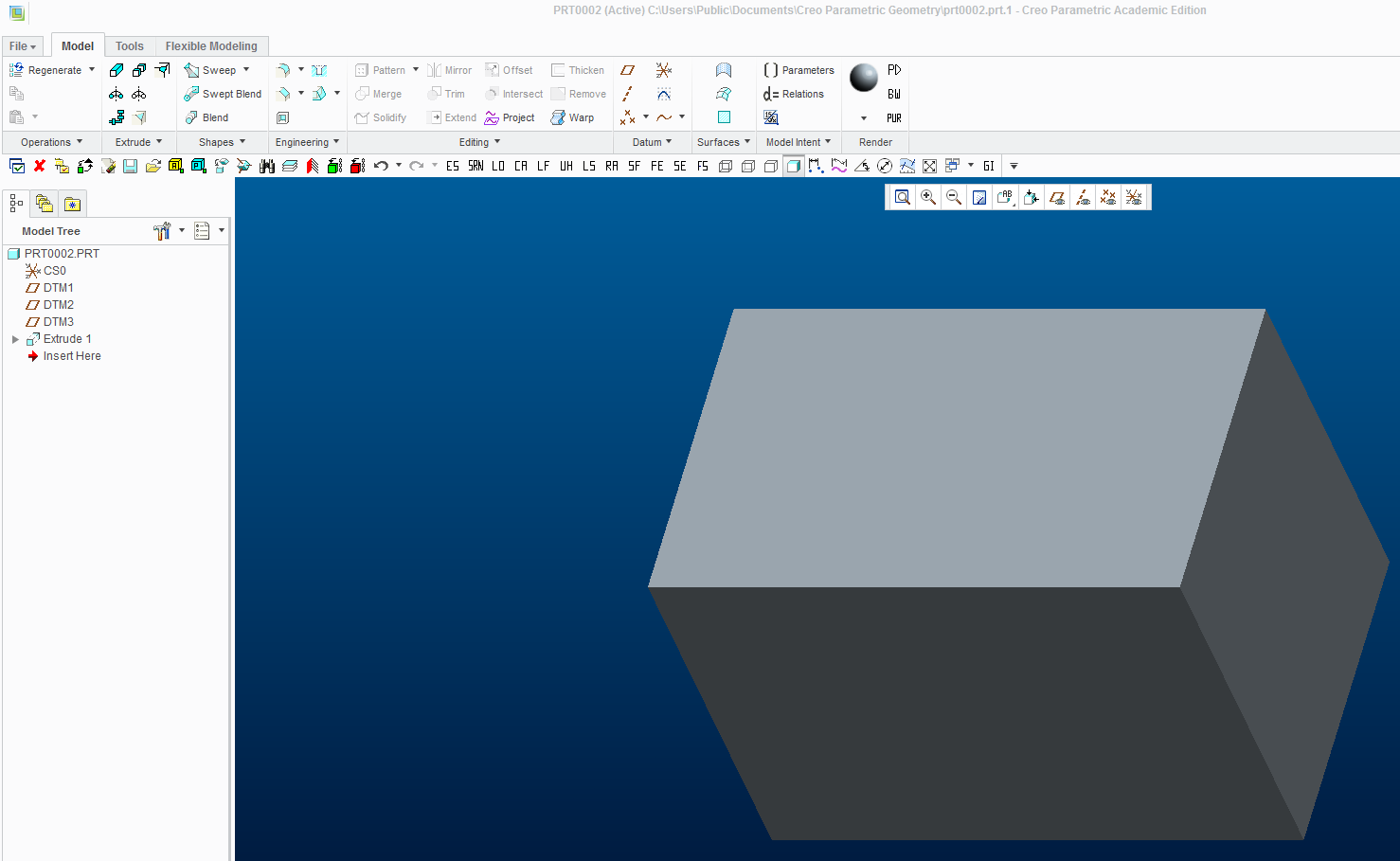

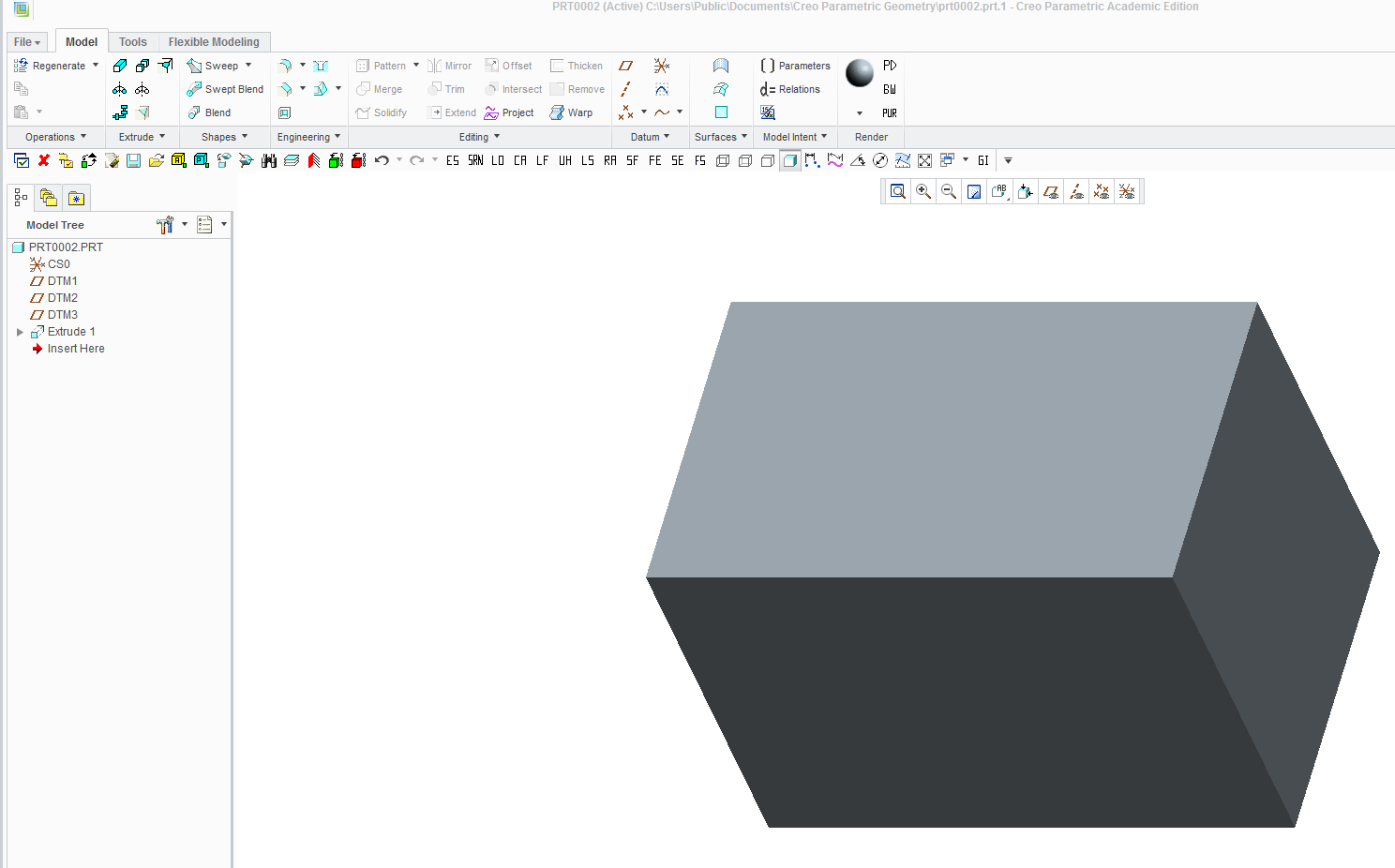

Screen shot 2 is the config change, screen shot 3 is the sketcher screen and screen shot 4 is the graphics area.
