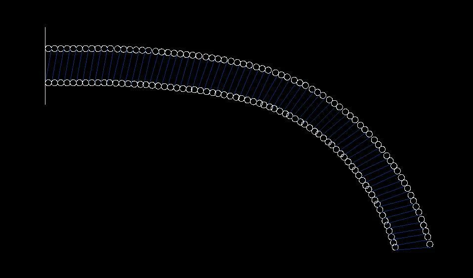

Morning all,
I am trying to model a spring with a bend in it, similar to the attached image. Cant figure it out, must be Monday morning.
Thanks for any help
    Jul 8, 2008 12:17 PM UTC
    Your helical sweep traj can be made in the initial curve direction, then create your spring.
    Jul 8, 2008 1:22 PM UTC
    See if this technique will get the job done.
    Jul 8, 2008 1:33 PM UTC
    For those that might be interested, I sent the attached to David
    yesterday. All it is missing is a swept blend using the intersection
    curve.
    Tom
