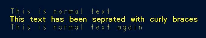

    November 1, 2011
    Use curly braces to separate that line of text.
    For example this note:
    This is normal text
    {1:This text has been seprated with curly braces}
    This is normal text again
    Will allow you to select the middle line of text by itself and assign a different font to it.
    That results in a note that looks like this:
    [cid:image003.jpg@01CC9887.0005D190]
