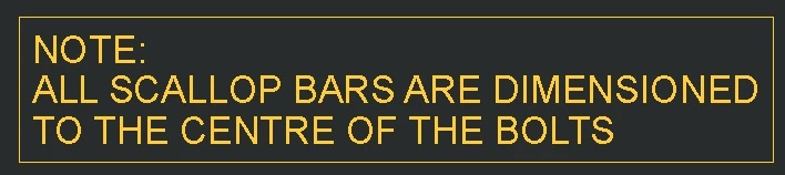

I want to crate box aroung multi line text.Each time I create sketched entities (draft goup) then relate to note.
If I go for "@[" before text it won't work. I want 1 box for multiline text.

    Have you tried making a single cell table with wrapped text?

    Sorry for the late reply.
    Yes.
    It's working.
