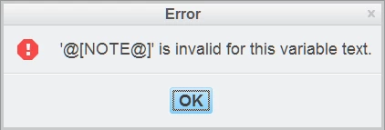

I'm trying to define a symbol that includes 'boxed' variable text in a note. I define the note with the '\' prefix & suffix. But when I place the symbol and try to enter @[100-T@] to replace the @[NOTE@] in the note, I get an error as shown in the attached picture. Does anyone have any ideas to get around this, or am I doing it wrong?

    Ray,
    If I gather this correctly, you're using a "symbol" that has some variable text built into it.
    While applying the symbol, you're modifying the text attributes within the symbol dialogue box with drawing note editing language.
    If so, I don't believe it was meant to work that way with symbols.
    So to answer you from your original post, I believe need to find a different approach.

    did you define your symbol with variable text?
    if so, then you can change what you want under the tab "variable text" as you are placing your boxed note.

    Ron,
    Yes, I defined the note text like so: \NOTE\. But when I inserted the symbol and changed the variable text to @[PART ORIGIN@], I get the error. Prefixing text with @[, and ending it with @] works fine in standard notes and produces a nice box around the note text.

    Ray,
