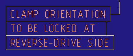

Hi all,
How do I go about creating a box around some text that is 3 lines long? if I use "@[Three line message......@]" then each line of the message gets its own box (see pic). I want the message as a whole to have a SINGLE box around it. Any ideas?
    Feb 25, 2016 3:29 PM UTC
    create 1x1 table and put the text into it. Unfortunatelly you cannot attach reference line to the table. Probably you have to create note containing spaces to this line.
    MH
    Feb 25, 2016 5:09 PM UTC
    Consider making a symbol which is a simple rectangle with a note in it.
    Feb 26, 2016 3:36 AM UTC
    Creo 2 or 3?
    This could be one of those new Creo 3 behaviors.  If you edit out the offending closing "@]" and opening "@[", does it make one big box?
    I think there is a full note editor somewhere in Creo 3.
    Feb 26, 2016 7:36 AM UTC
    unfortunatelly CR3 functionality = CR2 functionality. No improvement available in CR3...
    MH
