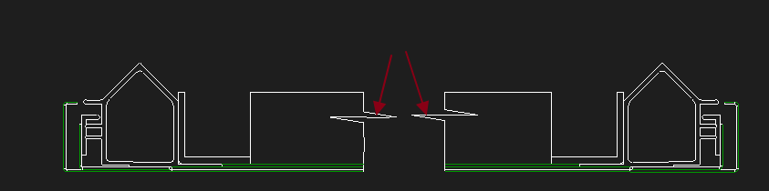

Break Line?
I know there is a setting to change the size of the of the break line, but I can't remember what it is. Can someone please help?

    According to PTC case CS97503
    Set the drawing option witness_line_offset to a desired value
      • The drawing_units drawing setup file option determines the unit of measurement for the witness_line_offsetdrawing setup file option
      • About this option: Sets offset between a dimension line and object being dimensioned. Also controls the size of the line break at the intersection of witness lines
