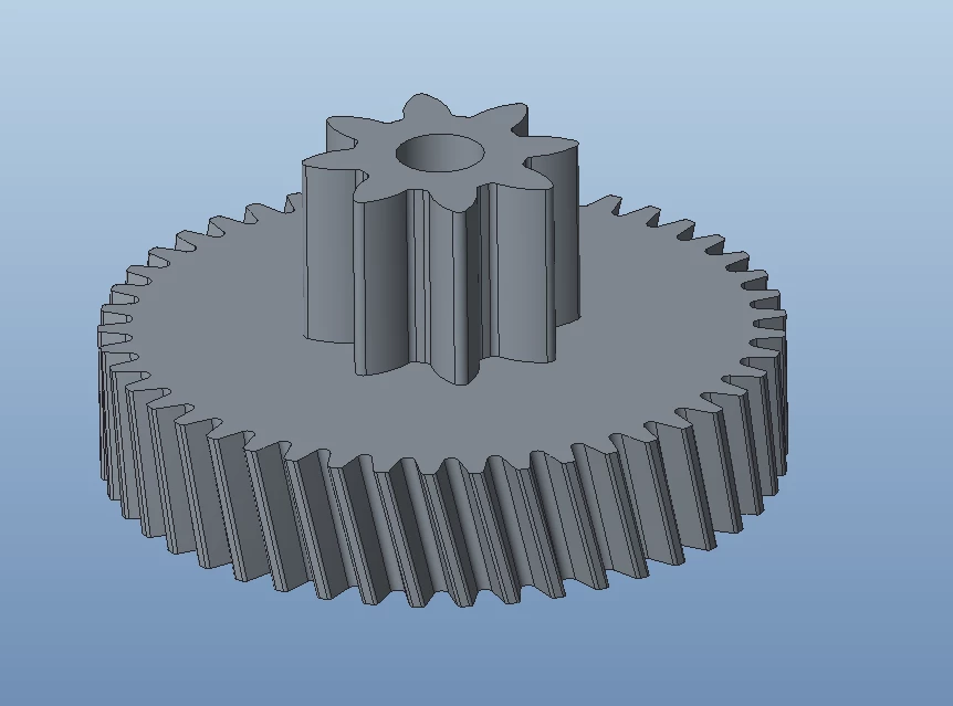

I have modelled this by measuring a badly worn gear from a piece of equipment, but I am not sure how best to go about finding a replacement. Does anyone know how to describe this gear?

    It is sometimes referred to as a cluster gear.
    It's a custom item. Since there is no undercut it is probably a pressed and sintered powder metal gear.
