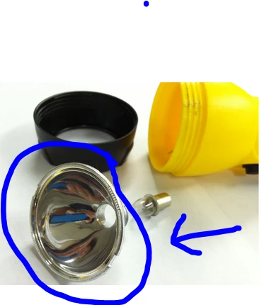

I am trying to make a focus for the front of a flashlight (see the attached file). I can make the shape with a revolution, but I want to shell it and put a hole for a light on the small end. Can someone offer advice on the best way to do this? Thanks!

    You can shell a solid revolve but that means you define the outside surface which is not the reflector surface.
    You might consider the revolve with a thickness instead. You get the option to add thickness to the inside, middle, or outside.
    You can also make the revolve as a surface and later add thickness if you want to add features before making it solid. Remember to merge different quilts before applying thickness.
