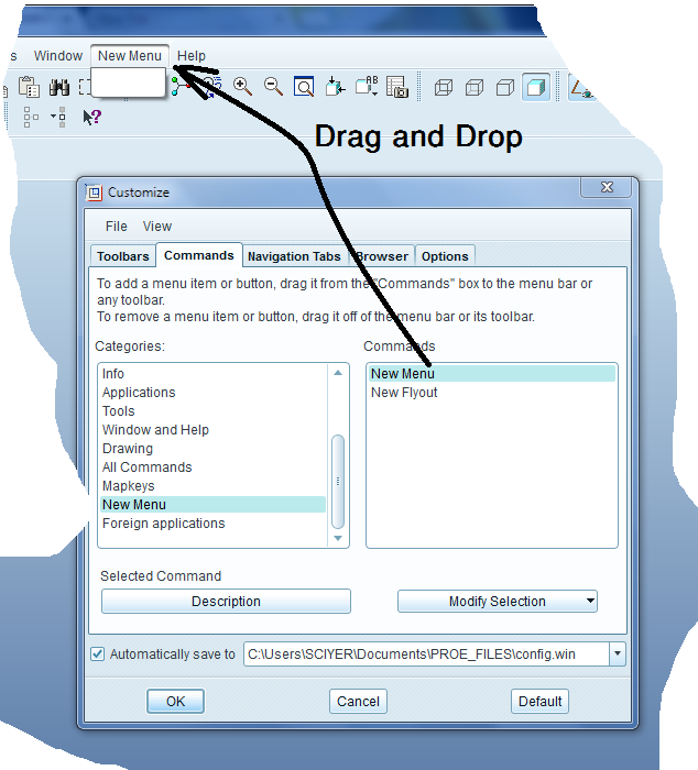

CANNOT ADD CUSTOM MENU AT TOP
Using WF5, have been trying for 2 hours trying to figure out how to add a menu next Help at the top. I right click in toolbar and select commands.... then select commands tab, then select New Menu from categories, the New Menu from Commands, then drag next to Help at top menu. I can rename but when trying to drag anything into this menu it does not work.... RIDICULOUS. Please help.
    9 replies
    Apr 27, 2013 6:46 AM UTC
    It is very simple. Tools --> Customise ---> Commands Tab... scrol down to "New Menu", Drag and drop the New Menu near the Help menu or where ever you want it.
    I hope this answers your question...
    SAP01010110-MarbleAuthor
    Apr 27, 2013 2:48 PM UTC
    I can do what you've shown, the problem is I cannot put anything in the new menu. When i try to drag something into the new menu it doesn't let me. Have spent like 3 hours trying different variations of the same thing trying to make this happen.
    Apr 27, 2013 7:28 PM UTC
    hold your mouse,as new menu opens drag inside till this appears------> |-----------|, then release
