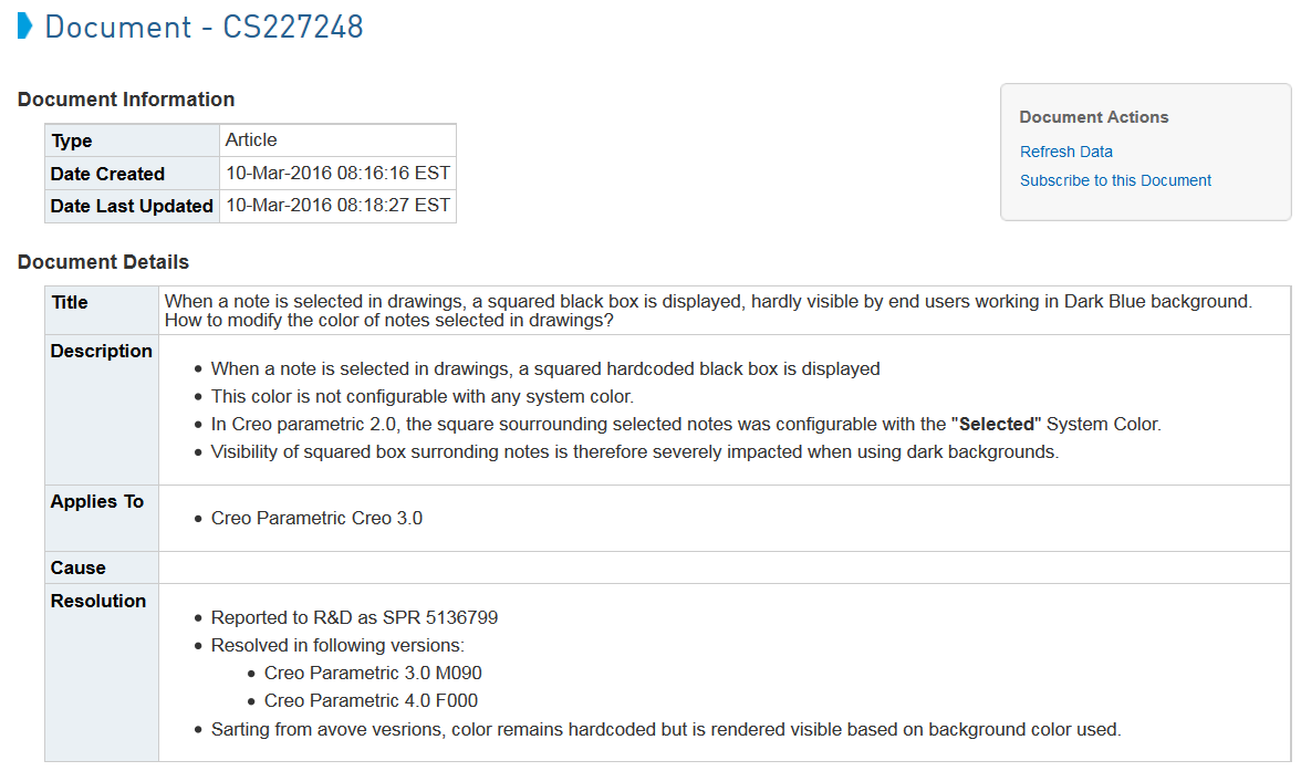

Change cursor color when editing a note?
In the new note editor the cursor shows as black when editing a note. When using a black background this makes it very hard to find where you're going to start typing. Is there a way to change the color of the cursor?

    Dan,
    Cursor/Pointers are controlled by Mouse setting in system. Not an option in Creo.

    The document is incorrect.  It's still not fixed as of Creo Parametric 3 M120
