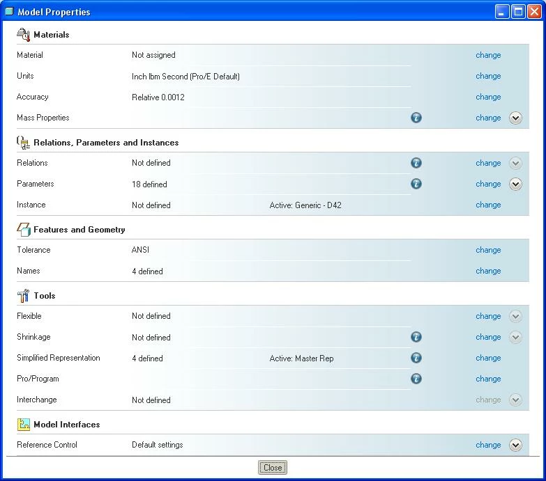

quick question, I´m beginning to play around with proe5 (I recently jumped to wf 5 from wf 3).
How can I change the units in wf 5? I need to switch from inches to mm.

    Go to File-->Properties. You'll get a pop-up (see attached) that will allow you to edit the units, along with various other model entities. This is similar to clicking Edit-->Setup in previous versions and getting the menu manager.
