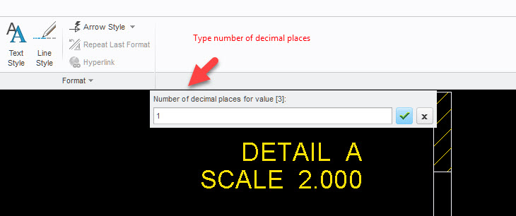

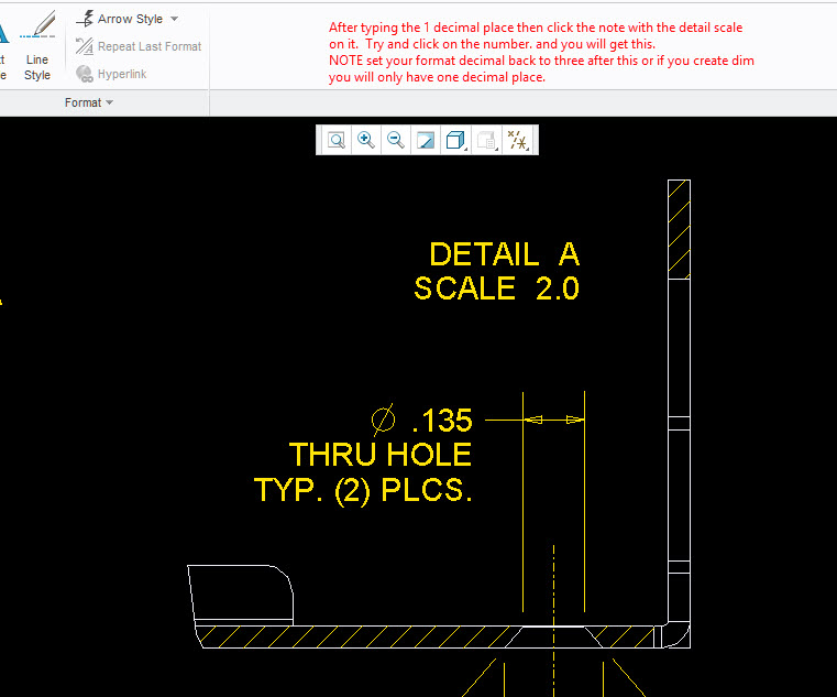

    Apr 14, 2017 12:32 PM UTC
    this is easily done right here  from you Layout menu tab in drawing mode.  Click the format down menu and then click decimal places
    Then you type the decimal places you want.
    Then you click on the 2.000 number, and you get this.

    Yes, it is easy enough to type in [.1] as I stated in my original post as well. Again I am looking for a default setting that applies this without having to take those steps. I am getting the feeling that there isn't functionality for this though so I will likely be creating a new idea for it.
    Apr 18, 2017 4:33 PM UTC
    Confirming it does not exist currently.  An option for default num digits would be straightforward to implement if approved.
