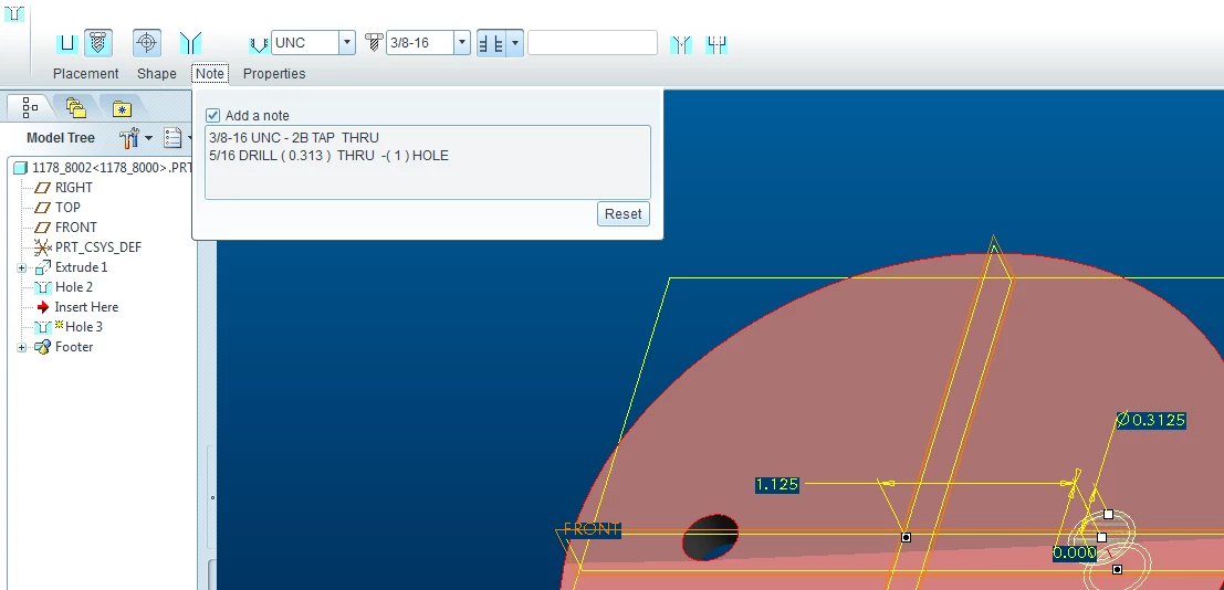

We have some internal washers made and on the threaded hole note, I would like to change the 5/16 drill (.313) note to a .### Dia. Laser note.
Is there a way to do this in these notes?

    You have to mess with the hole tables. You would be adding a new hole specific to laser.

    These are the only holes on the part, so would I modify these holes?
    Dec 26, 2012 4:38 PM UTC
    It all depends on your company's policy. Personally, I have no problem with applying my own note for hole callouts.
    Rarely is the PTC default what my clients prefer and they certainly don't want to pay me to manage hole tables.
