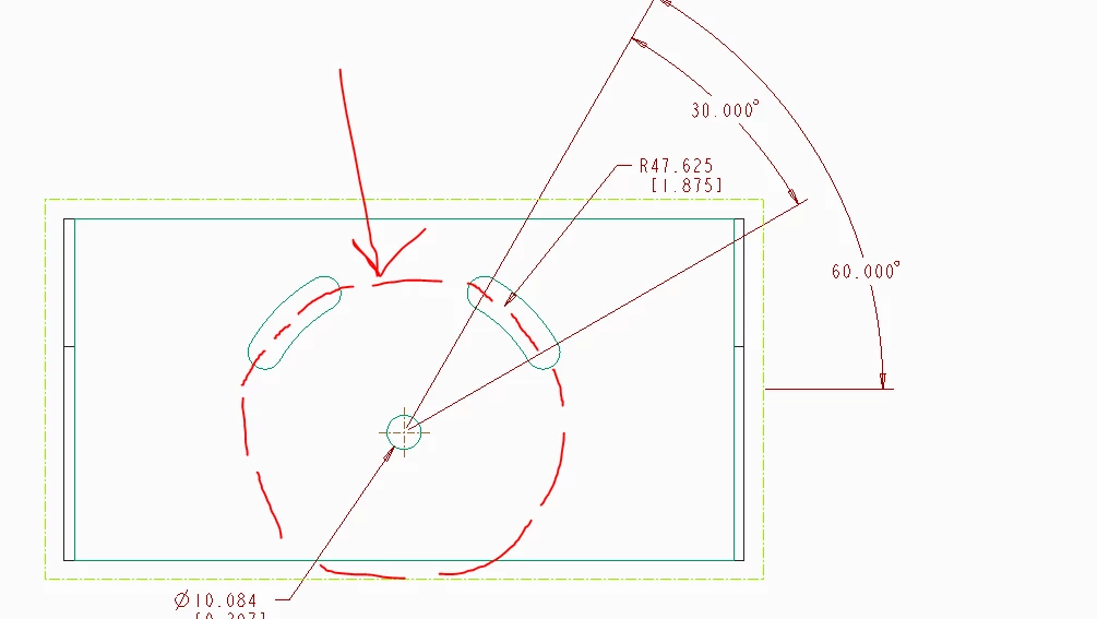

Is there a way to get a circle centerline to show in Creo 3?
I have been using cosmetics and hiding on layers.

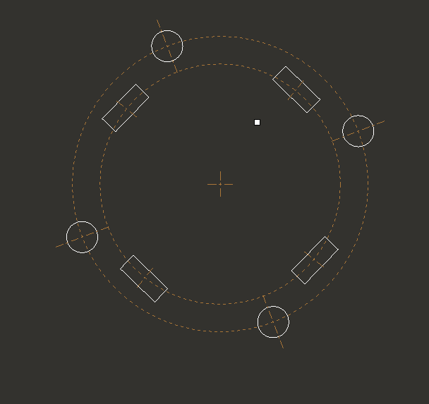

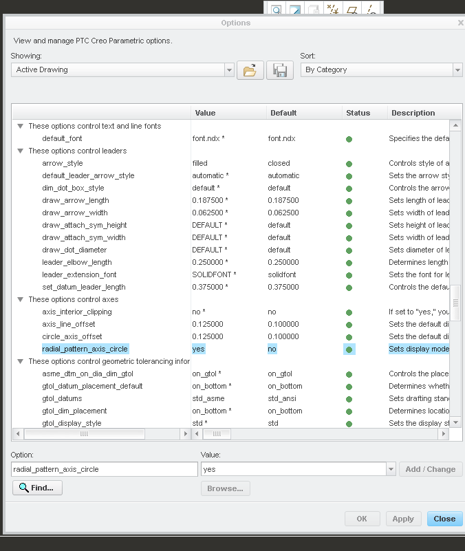

    Yes...IF...
    If you use an AXIS pattern to create your slots AND you have the drawing setup option radial_pattern_axis_circle turned on
    And I added an axis to the slot sketch

    Stephen...NICE. I tried on new geometry. Works as advertised. Unfortunately I am documenting someone else's model and they used 1 feature to extrude. I don't know if I want to redo the geometry. But I will keep this in my bag of tricks. Thanks!!!
