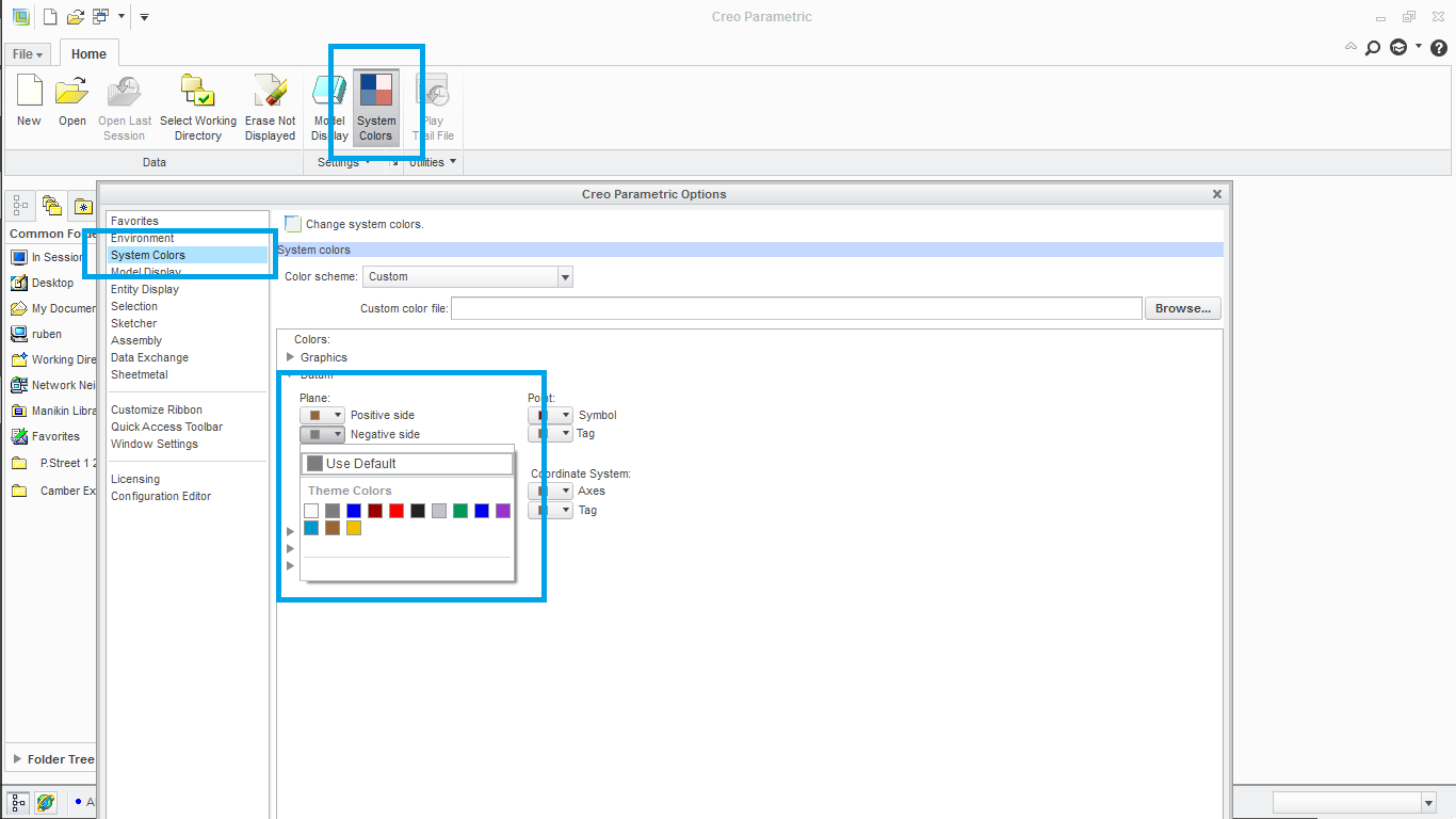

    I'm not sure if you can do that, however you can change the color of the datum planes doing this. Also remember that you can select the default datum planes directly from the model tree, so you are able to identify them easily.
    September 28, 2015
    all datum planes share same positive/negative side color. This color can be changed using a procedure reported by Ruben Alejandro Villarreal Barrios.
