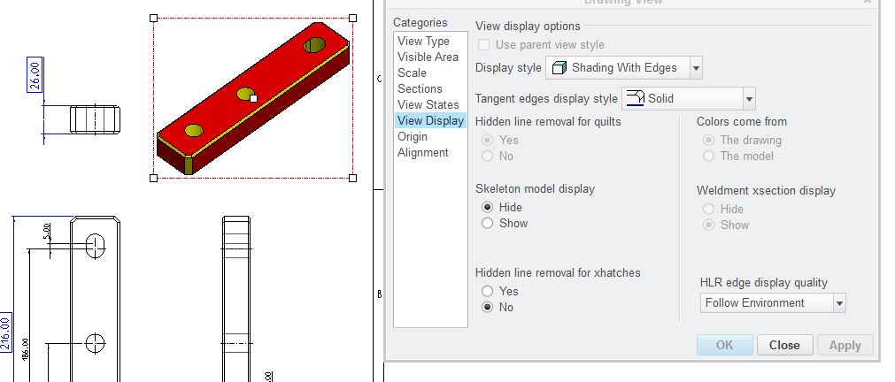

I recently try to show colored surfaces of a model into a draw in order to show milled surfaces.
The fact is I did not managed to do it, even with the option "color from model".
Can somebody can help me with this problem please?

Jan 8, 2014 6:55 AM UTC
Gilles,
you have bad luck . Color from model is displayed on the drawing only if you color whole model (not specifiic model faces).
In Part mode you can select specific model faces and create their copy (CTRL+C, CTRL+V). This way you will create Surface quilt which is displayed in Quilt color on the drawing.

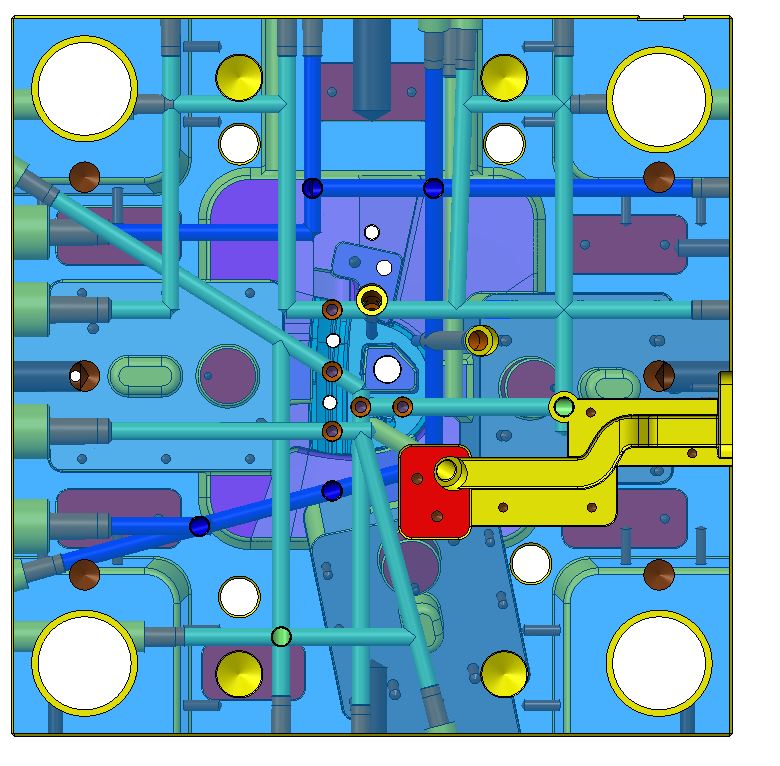

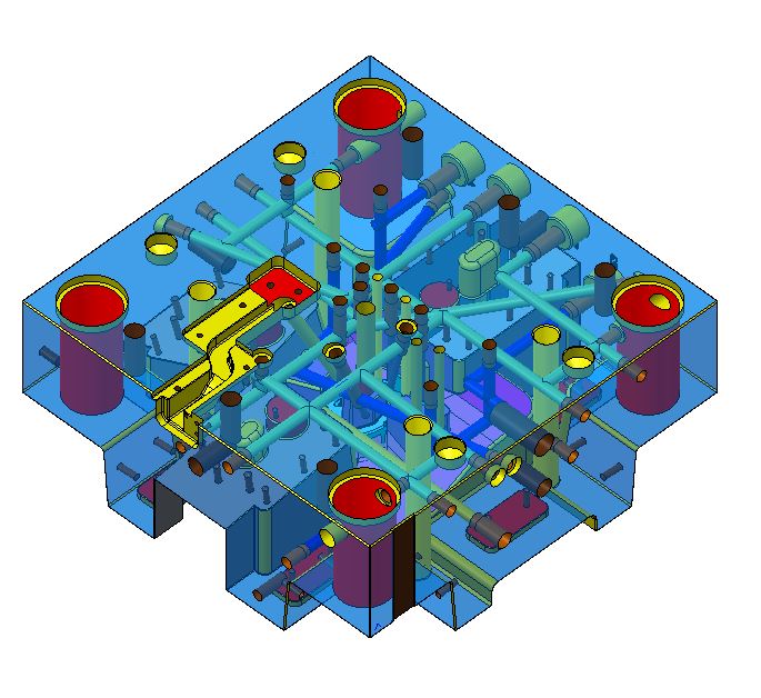

Hello again,
i'm not sure if i understand what you want to do, but when i want to show the colors of the surfaces and at the same time other features, i use a shaded view with transparency.
Top view
iso
