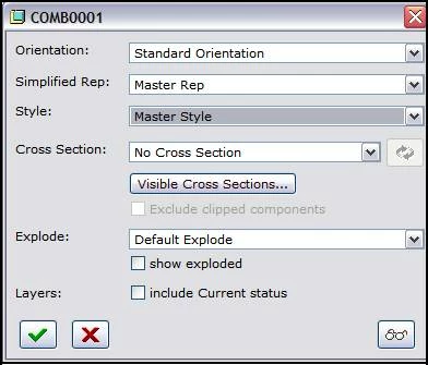

    To follow up on Tyler's suggestion, you can modify the new state by
    clicking edit --> redefine. You'll get this pop up:
    Combined states are very useful for setting up an exploded view drawing
    of simp reps. When you add a new drawing view you'll be prompted for
    the combined state and your view will already be set up for view,
    exploded state, and simp rep state.
