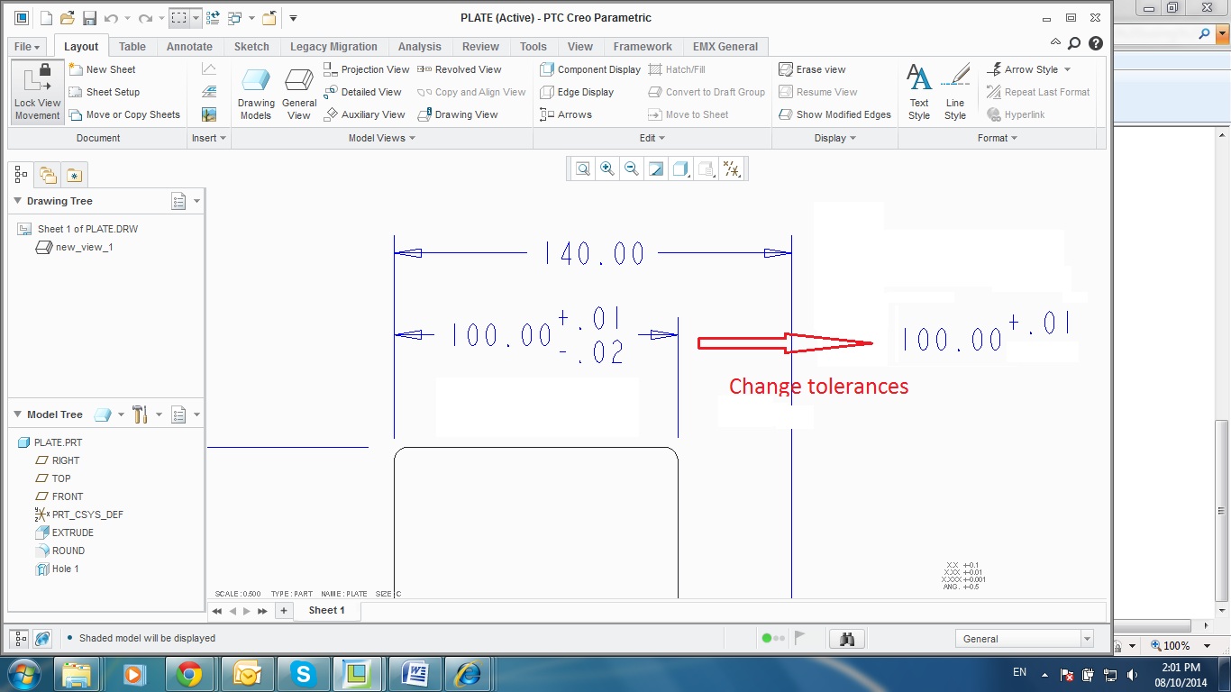

Configuring Dimensional Tolerances
How to change dimensional Tolerances as picture ?
Plz help

    if lower tolerance value = 0, then you can hide it on the drawing.
    • click File > Prepare > Drawing Properties
    • click change in Detail Options line
    • set blank_zero_tolerance yes

    does this mean that lower tolerance value = 0 ?

    Correct ! Thank you very much.
