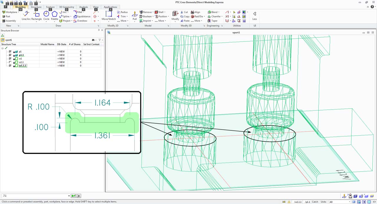

Connect 3d curves? Removal of material?
I'm sorry to be asking for basic help but I seem to be having a hard time.
Edit: 3d curve is referred to as wireframe in other cad programs?
I am attempting to make a body with space hollowed out inside.
I've created a circle and pulled it a distance through the body which hollowed out an area.
I then moved the work plane down and created the internal shapes I need... Except now the material is not being removed from the outer body (no internal space created).
How do I remove material from a body using 3d curves?
Also how to I attach 3d curves to each other.
Arrows in my image are pointing to where there is a disconnect between features.
I've also attached my wip so feel free to get me going in the right direction.
Thanks for the help.
Truly appreciated.

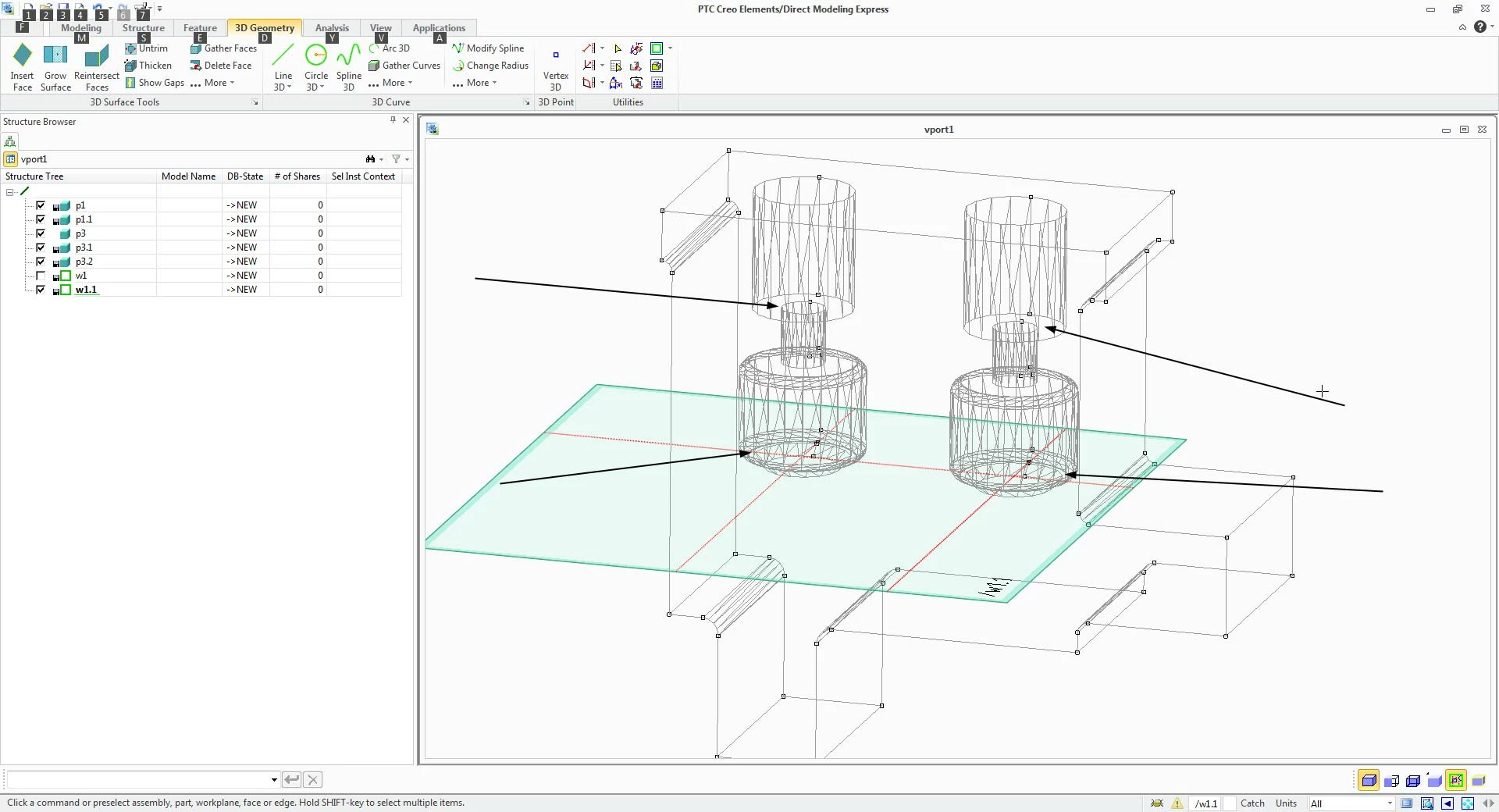

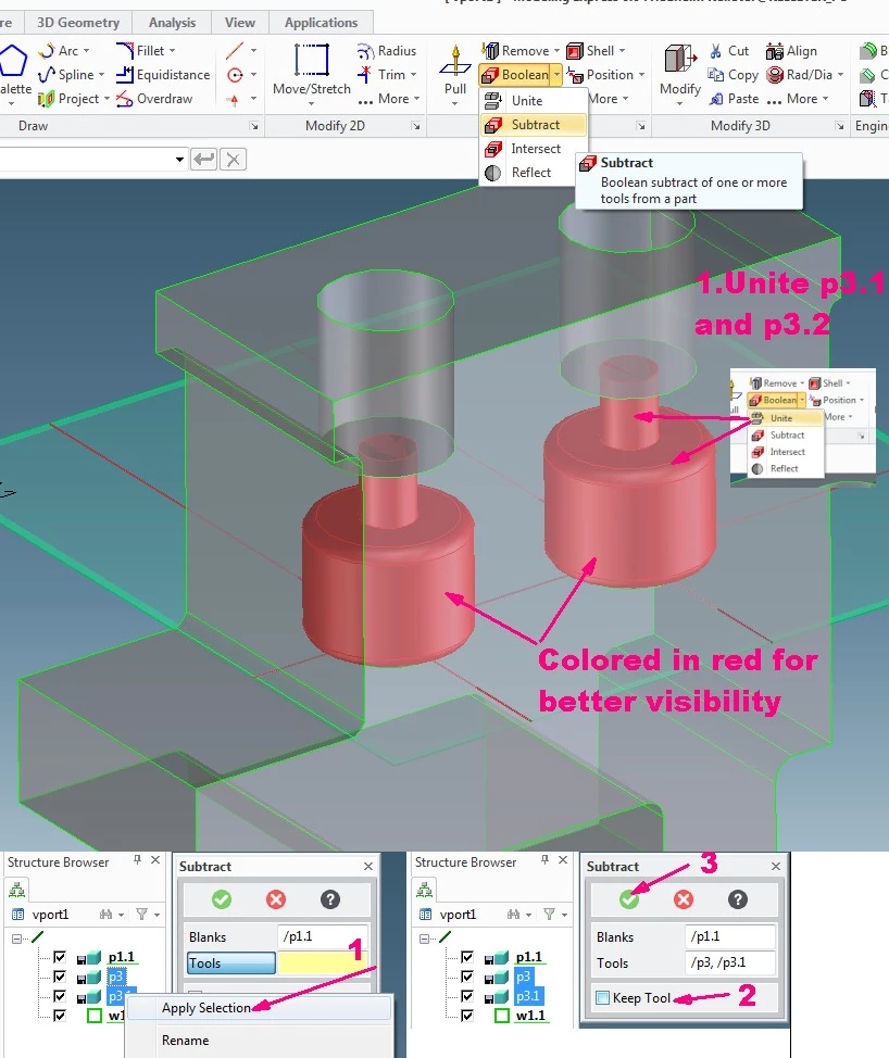

    Jan 29, 2015 11:04 PM UTC
    Hello Charles
    i dont know how to
    But there are other ways to achive the Goal.
    Have a look at the attached pictures.
    Much success and fun with the program

    CJB_JHB1-VisitorAuthor
    Jan 30, 2015 3:21 PM UTC
    Thank you!
    Simpler than I expected.

    Hello Charles

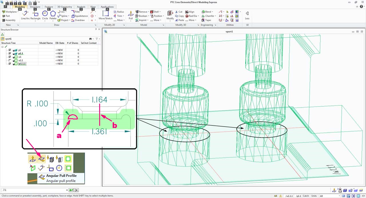

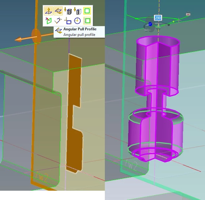

    you could again remove with angular pull.

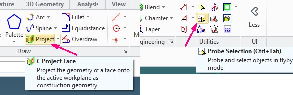

    Create a new workplane on axis of the inner form.
    Then get the existing elements like in te following picture.
    With the Probe Selection it is possible to catch elements inside of a part.
    Push the button, klick on the part where is the element what you want to get.
    A table comes up and wen you go slowly with the cuser over them, the elements will by highligted.
    Then switch of the part, draw geometry a and remove material with angular pull arround axis b.
