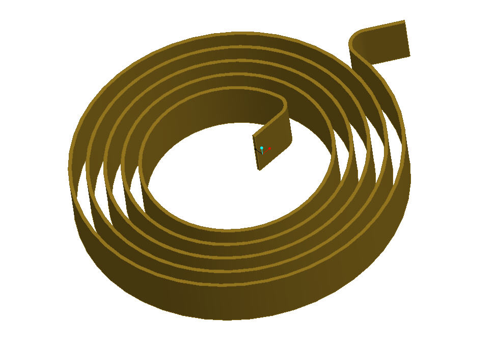

    For example:
    This was started with a Curve From Equation / Cylindrical with the relations:
    x=2+t*2
    r=t*360*5
    z=0
    Then create a Sketched Curve, copy the first Curve with Use Edge, add the end details, and use this Curve to create a Sweep.
    September 16, 2010
    Probably the easiest way is to create a Curve by Equation for the spiral and build from there.

    For example:
    x=2+t*2
    r=t*360*5
    z=0
