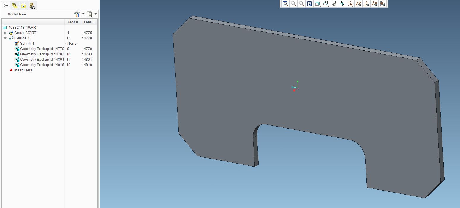

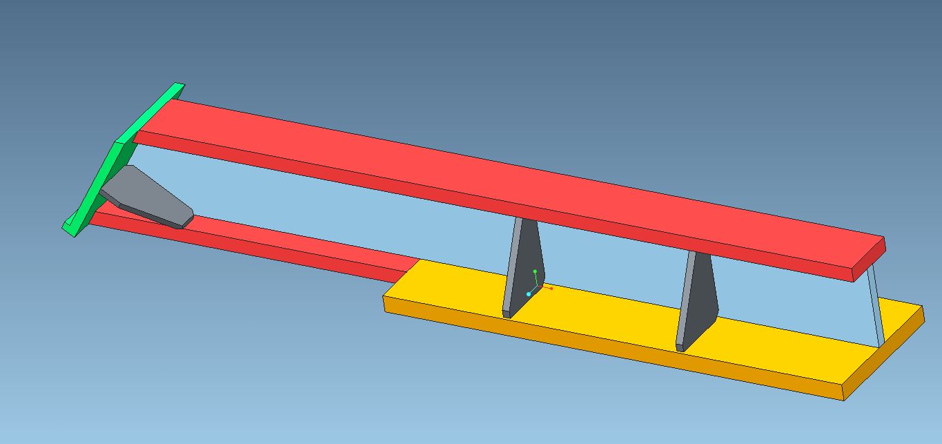

Ok, I am trying to model a stiffener between the two grey gussets shown below.
I want to be able to use the inside of the gussets as references along with the red and orange plates. I am obviously a little confused on how to use Copy and Publish Geometry features in Creo. My counterparts did this using "Geometry Backup" shown below.
How do I do the Geometry Backup shown for this stiffener? Thanks!

    I figured it out, those are referenc lines from Sketcher. They create the Geometry Backup when you activate the part in the assembly and create your sketch from there.
