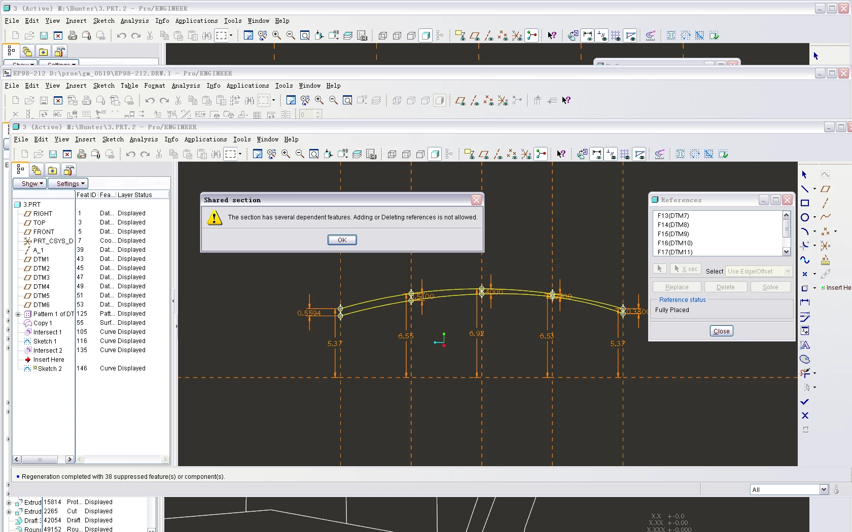

could not add or delete reference in sketch
hi, guys
I encountered an issue when I was editing a sketch, the system give me a hint: you could not add or delete the reference,
thanks in advance

    Probably the feature described by the sketch is mirrored. You will need
    to delete the mirror, make the change and remirror. Usually the mirror
    command is not as useful as it seems.

    actually, i found a clue that I`m not sure, all the datums in the reference of this sketch are in a same pattern.
