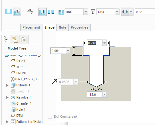

Hi everyone.
can anyone tell me how to modify a counter bore hole havong custom size.........
I wanted a CBR hole having dimensions D=0.218 deep=0.051: d=0.157 through.
In creo the option to enter 'd' value wasn't highlighted.
Please someone help me out here.
Thanks in advance.

    Tapped holes are driven by hole tables which fixes the drill size for the tap.
    You would create a second through hole using the normal hole rather than tapped.
    You have to play a little with teh dialog. There is alot hidden under those buttons. It includes standard clearance holes for certain bolt sizes, countersinks, and other stuff.

    Thank you guys.
    I got the way to do it.
