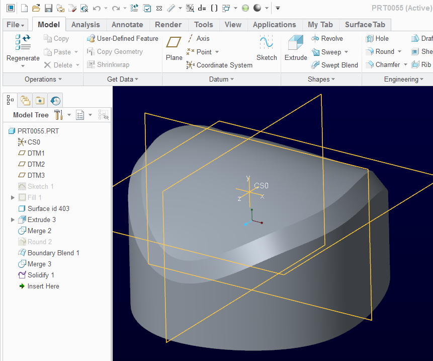

    Mar 11, 2016 3:30 AM UTC
    ...Or this (Creo 3 commercial version attached)
