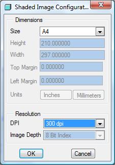

    If you need create pictures from model or asm set ProE Background: (white/black or custom color) View > Display Settings > System Colors... >> Scheme > Black on White.
    Set orientation for model or asm and create Screen Snapshot: File > Save a Copy... > Select type - /JPEG (*.jpg) or TIFF (Snapshot) (*.tif)/ and set Configuration (Size, DPI etc.)
    Note: if you want create nice rendered pictures >> use Render Control mode: View >> Model Setup > Render Control...
