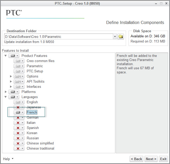

Creo 1.0, need to change the language
Hello, I'm a french student and I want to turn the language into French. I downloaded the option french but i don't find it.
Thank you

Yassine,
To use Creo 1.0 in French:
1. Creo 1.0 needs to be installed with french language option (Check image)
2. Set system environment variable PRO_LANG as french. Select Start > Right Click on Computer > Properties > Select Advance System Settings > Advance Tab in System Properties > Environment Variable > New > Type Variable name as PRO_LANG and value as french.French.jpg
Good luck and welcome to forum.

Yassine,

Thank you for your correct answer Mahesh
